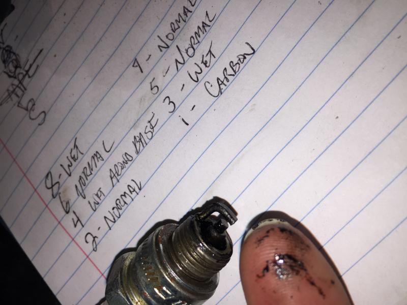

#2>I pulled out all the plugs and wrote down the conition (see attached picture). I also gapped them to .040, they were at .035. I pulled the #8 spark plug back out after my last attempted drive and it was wet again (shown in pic). I assume its oil.

Update: cant afford a compression tester. So during my lunch break today I Pulled the #8 spark plug and connected it back to the spark plug wire. Set it on ground and cranked the engine over. No spark! Pulled a spark plug that was burning normal and swapped it out with the #8 plug and it sparked while cranking. It seems that I have bad champion spark plugs. Going to get some autolite plugs when my chief financial advisor(my wife) allows it lol

At least you have one clear visual indication of something wrong, #8 plug. It may be defective, fouled or worse, your #8 cylinder is bad in some other way. If a plug doesn't fire and gets gasoline fouled, that's expected but if that was oil, that's not good.
