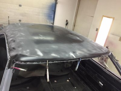

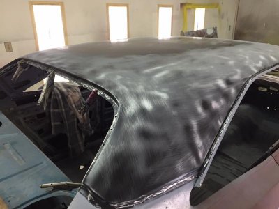

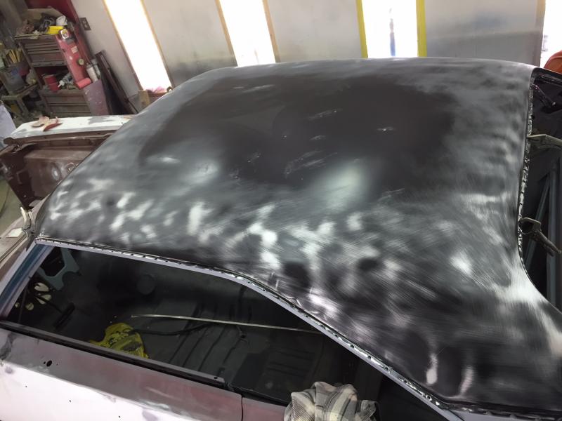

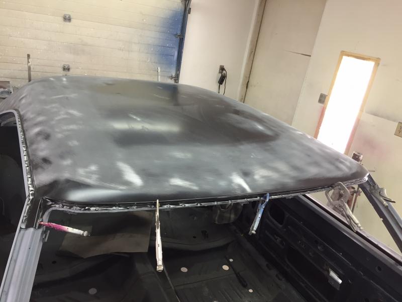

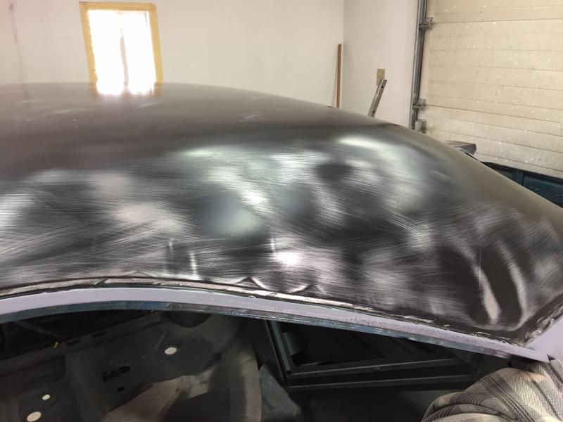

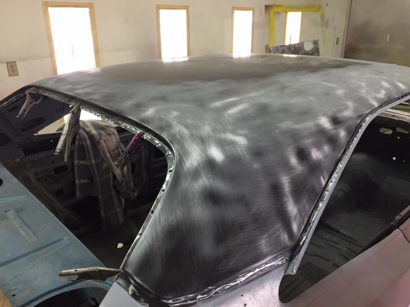

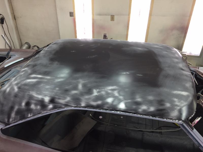

Recently my body guy suggested to replace my roof skin due to the original vinyl top causing issues. So of course I buy a skin from AMD. The roof skin came in a nice thick sturdy box, no visual shipping damage. After my body guy and I took the roof out of the box and put it on his body parts stand, he ran his hand along the roof and noticed lots of waves in the metal. After talking to my body guy about our time frame to get the car done, we decided to keep the roof rather than return it to AMD, in hopes to get a better quality one. Currently I have sent an email to AMD and waiting for there response. I was wondering if any one else had similar parts quality issues with AMD? Thanks

AMD makes the best fitting aftermarket panels for our cars, hands down. That being said, most of them are not perfect and require some work to be correct. It's just the way it is. Never the less, AMD's parts are far more correct than a lot of other's out there on the market. Heck, some producer's of aftermarket sheetmetal out there are so bad, that you wouldn't even think it was for the correct vehicle.
Being in your shoes, of course I could see the frustration with buying sheetmetal and pay the shipping for something that's going to cost you more to get correct. I believe AMD is the only one stamping a roof skin for that car. If you didn't have that, look at the situation you would be in. 1) Have to patch and try to repair the leaky star gazing roof that was on there. 2) Find a donor vehicle, with a good roof skin to replace.
I just got done putting a donor roof skin on a Dodge Dart. For one I had to find a decent roof, drive 9 hours to get it, pay $400 dollar's for it, drill out all the spot welds (about 100-120), grind the stitch welds out at the pillar's and melt out the lead.......Then do it alllllll over again on the original roof. Honestly, if AMD made a roof skin for a Dart, I would have ordered one from them in a heartbeat before going the donor route. Look at all the extra time, gas/money, travel I spent for a donor roof. Being you're not doing the work, a donor roof for you would have definitely cost more money & headaches vs. the AMD skin.
Again, I can see where you're coming from (spending that kind of money) but be assured, the AMD roof is probably the only place you'll get a roof skin, and again, probably has cost you less in the end anyways. A lot of good body guys will skim coat a roof anyways (for a nice flat surface), and looking at those "waves", that's about all it needs anyways

that piece is unacceptable in my opinion......... usable, but unacceptable

No problem with the pieces I ordered, but you'll see that in any repop piece. My cousins fender from Year One was is worst shape then the one he was replacing it with. Just skim coated and break out the long sanding block. Got lucky on my rear panel for the Coronet, but all pieces will need skim coated to make them straight. Even the factory cars aren't perfect.

Yes, sucks that they aren't 'factory', but as others said, find someone else selling an entire roof skin.
For what you have there, a skim coat of filler, some blocking and a couple coats of spray-poly and you'll be in good shape.

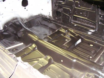

I used an AMD one piece floor pan in the last Duster I restored a few years ago. The fit and quality was very good. I have never had any major problems with their stuff, and I still believe they are the best on the market. I see what you are talking about with the roof panel though. Good luck with it, and please keep us posted6-16-09 Duster 029.jpg.
