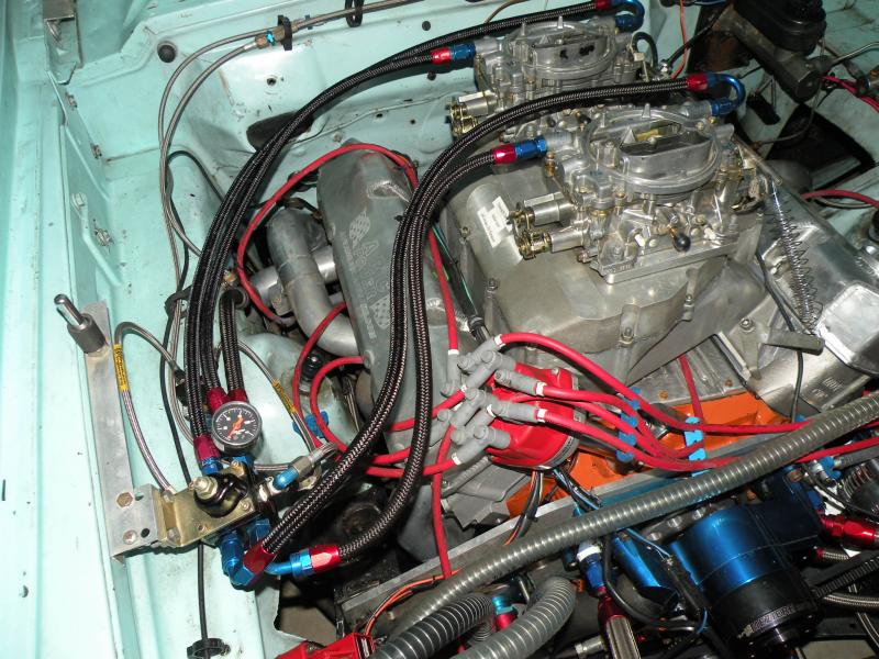

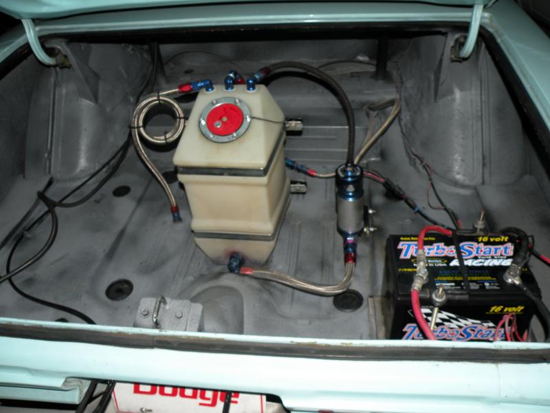

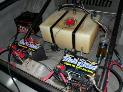

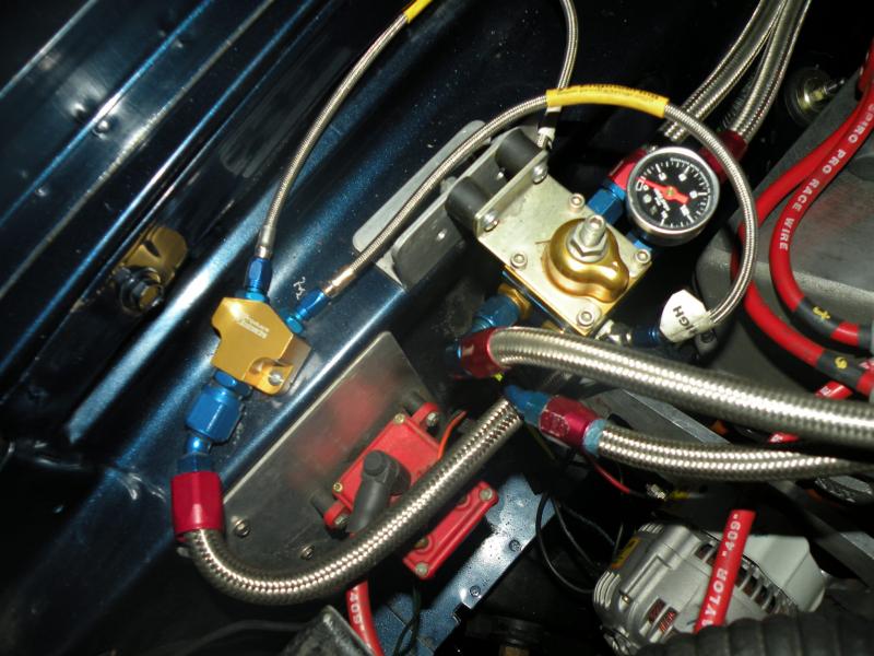

I went 9.36 @145 last weekend at Bowling Green in 90 degree weather. I run a Barry Grant 4 port. I've noticed the fuel PSI reading 4 psi at times and 6 psi at times. It performs the same with either reading. Not sure if the regulator is the issue or the fuel pressure gauge isolator. I would think if it really had 4 psi performance would suffer. I run a Performance Engineering pump w/ -12 to the pump and -10 to the regulator. (4) -6 feeds to the 750 Eddy carbs.
