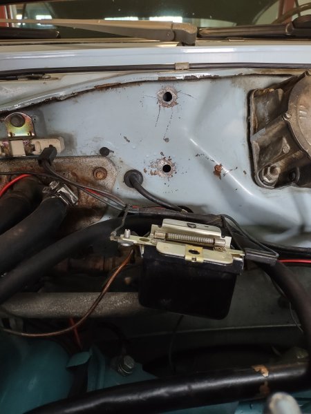

I'm looking for opinions. I'm tired of trying to tighten items in the engine compartment that attach to the firewall with self tapping screws. I have a nutsert tool and it seems like a good idea to use it. The only problem I see is the loss of originality. Anything that needs a ground would still have one. What do you guys think?

A great idea. Just make sure the paint is off around the hole so the nutsert provides a good ground path. I boiled a battery and caused some overcharging damage because of loose sheet metal screws holding my voltage regulator to the firewall. Go for it.
Good idea! I have a nutsert kit and I think I will use it to remount my voltage regulator. I am not happy with the loose self tapping screws.

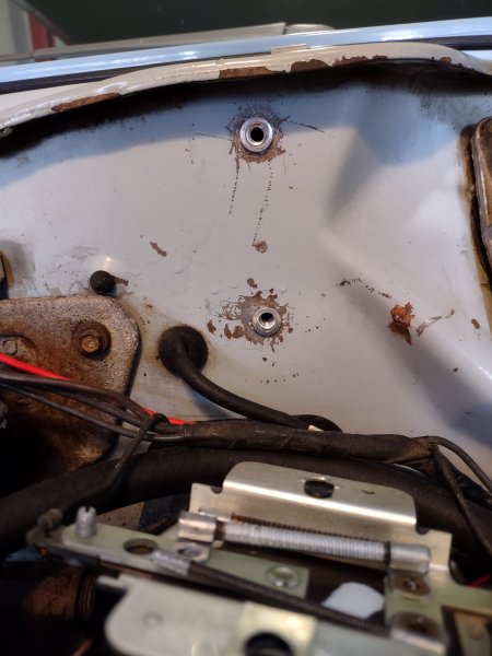

Nutcerts are great, use the correct one for the material thickness. I used the ones with the serrated teeth on under side on the insertion end which helps to prevent them spinning loose. Make sure they are pulled up properly so they mushroom as intended without overdoing it. #6, 8's and #10's can strip out threads easily if over pulled. Remove some of the paint in the area where you install for good grounding of what you are mounting. I used for ignition control module and volts regulator mountings and never had a problem.

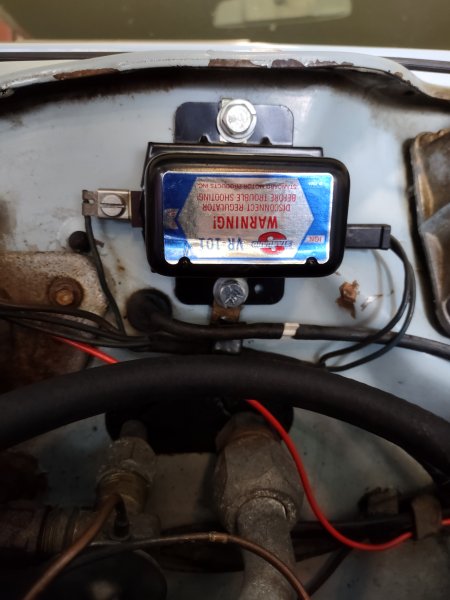

I used 1/4 inch nutserts to mount my voltage regulator today. They worked great!
