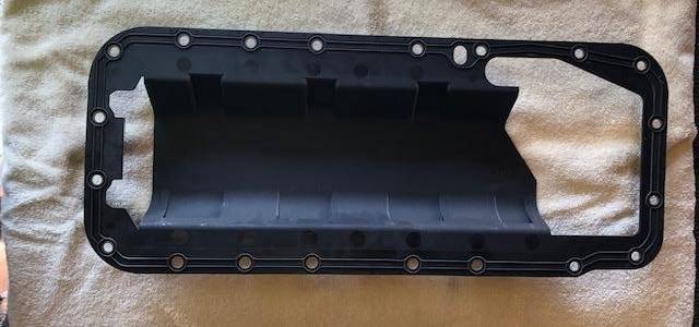

I have had one hanging on the wall for awhile. My pan gasket started leaking a bit so I may try it.
It took me 3 years but I swapped mine in late last year. NO leaks!
I pounded out the dent in the pan and repainted it too.

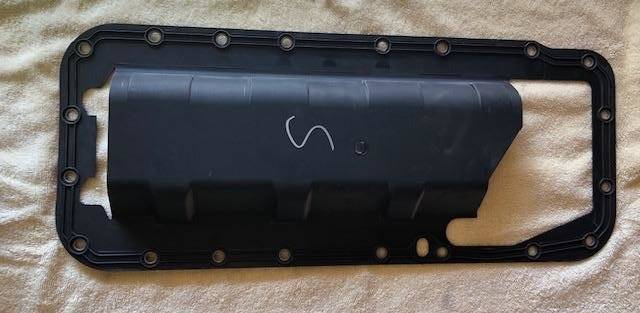

It first worried me the thin drainage slots:
The slots turned out to be bigger than the steel tray had.
