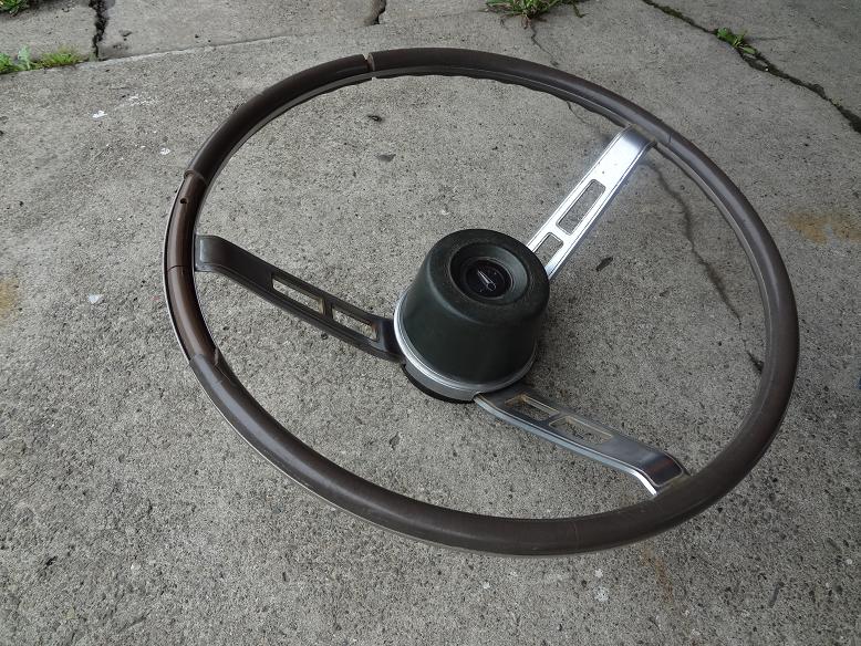

steering wheel

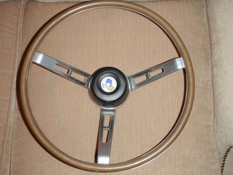

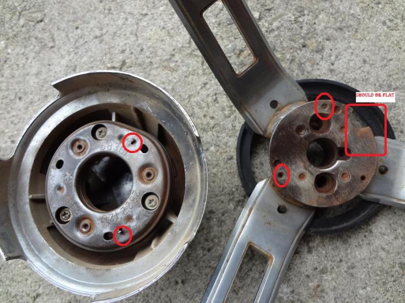

Picked up this steering wheel from a fellow 70 RR owner. Is it a 70 wheel ? Wheel fits on the spline but how do I secure the centre piece. Area in the red box has a been bent ? so the centre piece is not flat. Do I flatten this.
The centre cap - i have circled 2 small lugs that I assume line up to 2 of the holes in the wheel centre ?

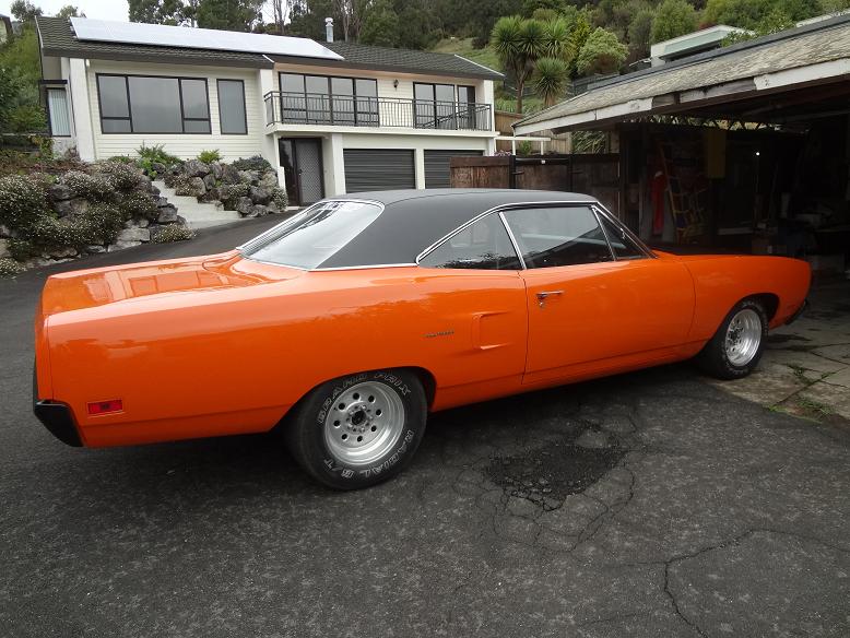

I have put the rims/tires that came with the car back on.

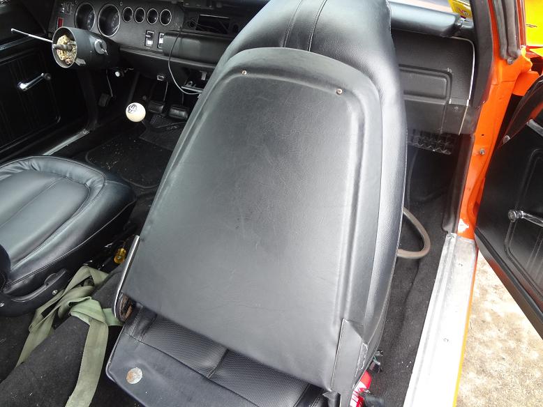

Seat backs were in a bad way so I covered them with vinyl.
Rim needs some repairs but will look good.

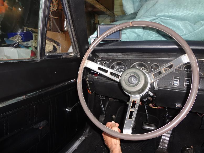

Steering looks good - looks just like my steering wheel except for the center emblem! I think they are great looking steering wheels, and I like that they match the wood grain handle of the pistol grip shifter too...
Hawk
nice wheel. and I am digging that you are getting some cool miles on the car.
Thanks for posting the pic of your wheel Hawk , am stoked that my wheel is correct. Will spend some time on it this afternoon. Get her out for a drive too, will visit the guy who i purchased her from.

Steering wheel is on, was missing the 3 original screws that hold the horn cap bracket to the wheel but found some to fit. Off for a drive now.

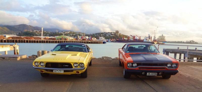

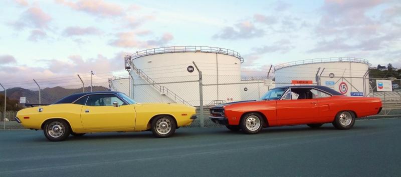

Talked my partner into driving the Challenger so I could get a couple of photos of both cars, we went down to the port area. I don't know who was more nervous, her or me. Bit different from her S40 Volvo but she did great.

Hi HYRDGOON, you could be right , better change the lock on the garage maybe. Would solve the "why have 2 cars when you can only drive one at a time".

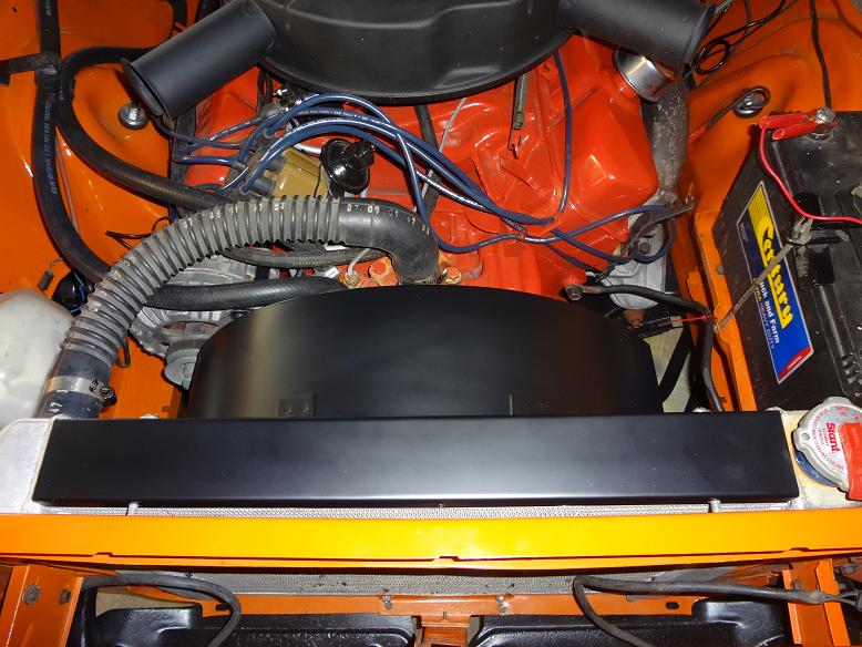

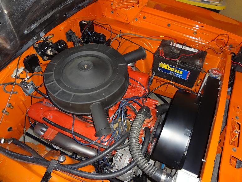

Made up a fan guard for the radiator , am rather attached to my fingers. Oneday I will get a authentic radiator.

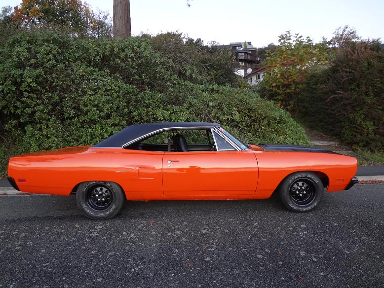

rims

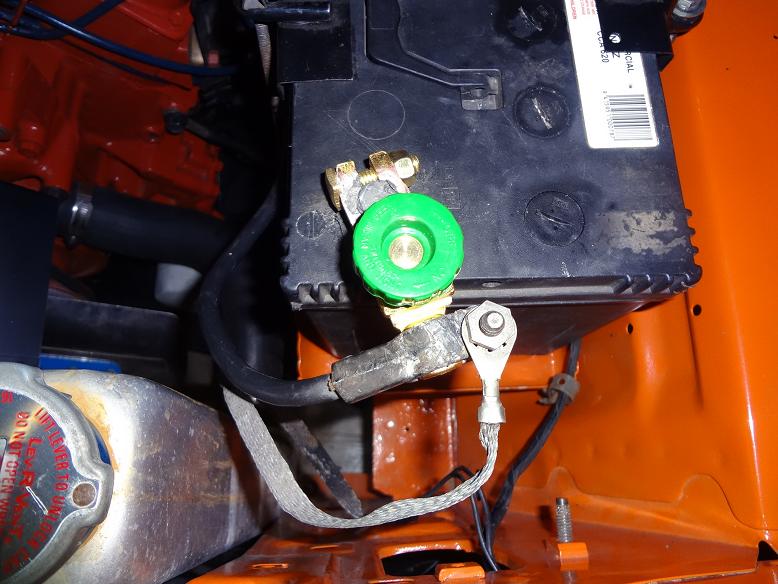

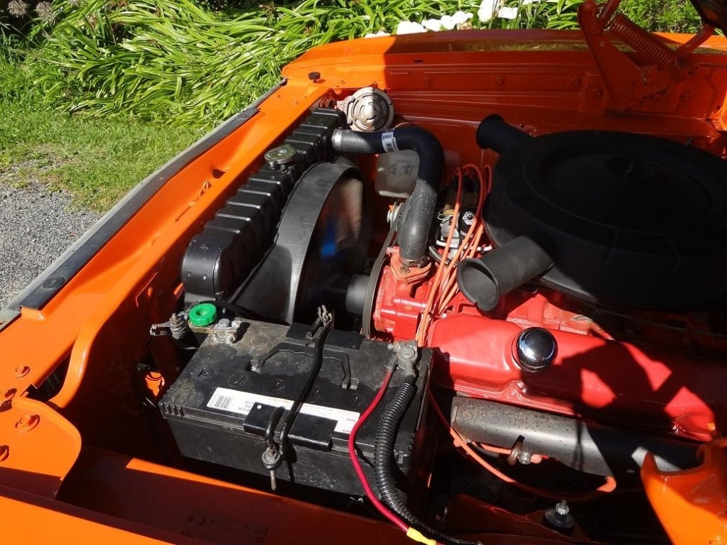

Had the battery go flat on me twice . Had it tested and it checked out fine so must have a power drain. Put a clamp on the negative post that has the ability to open and close the circut with a turn of the green wheel. I can now use the car when I want and hunt out the fault.

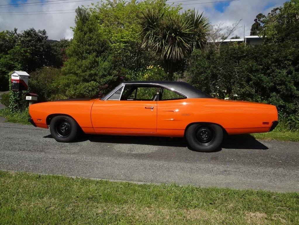

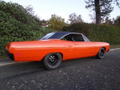

My ideal rim is a black steelie but not in my budget this year so today I prepped and painted my alloy rims with great results. Love the mean look of the black rim.

I like the rims Tony, they go well with the car and compliment the orange.
For your battery drain issue, I would suggest you start by hooking up a multi-meter to measure current flowing from the battery. Assuming you show a small draw, then slowly pull out fuses, one by one, until the current goes away. This is a way to isolate the circuit with the issue.
Believe it or not, dirty battery terminals can also drain a battery; yours doesn't look bad, but just make sure the terminals are nice and clean so they make good contact. Good luck!
I like the black better myself, looks cool but like you I really like the black steelies.

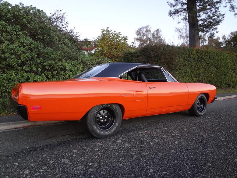

Rims, always wanted steelies so got 15x8 's. My Cooper Cobra 275 and 235's wrap them nicely.

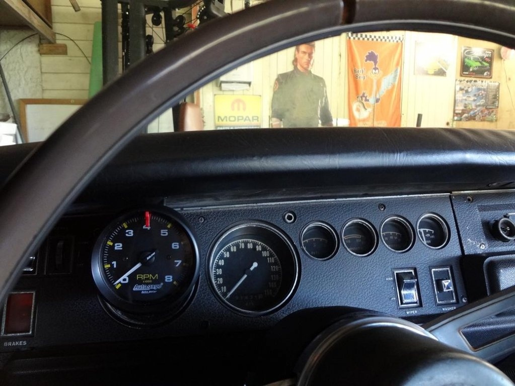

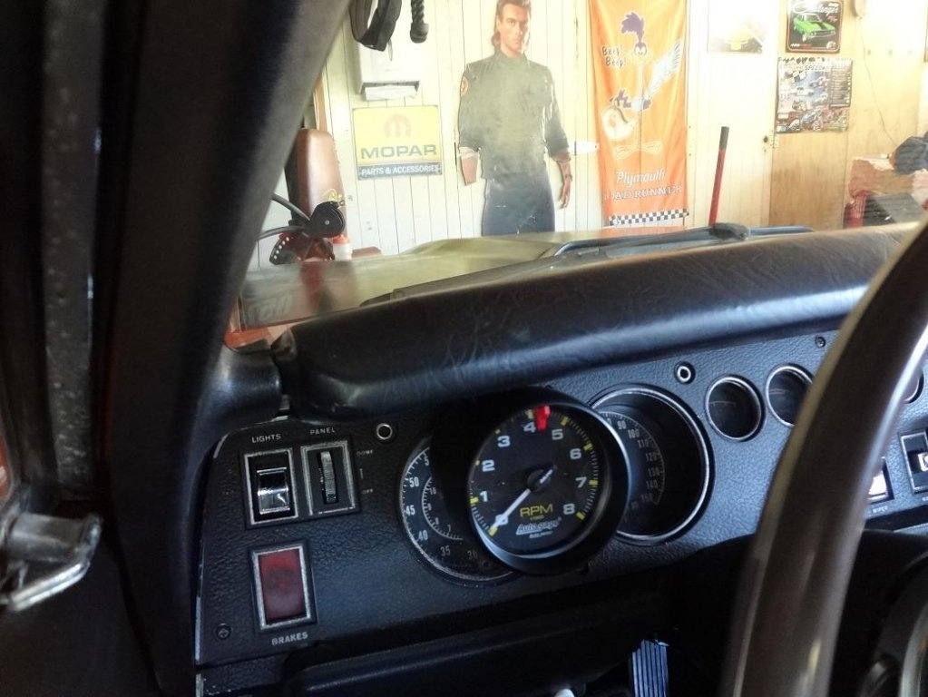

Like a Tacho gauge and found one at Summit that meet the look I wanted. Easy to fit and works/looks great. My engine is an unknown as we just removed it , cleaned and painted and put it back. Runs smooth and quiet. Keen to get some more HP so got a Mopar Performance Cam. Plan to do some head work next year. My engine builder warned me that we won't know what we can do until the heads come off. If the bottom end is tired I may need to spend more.

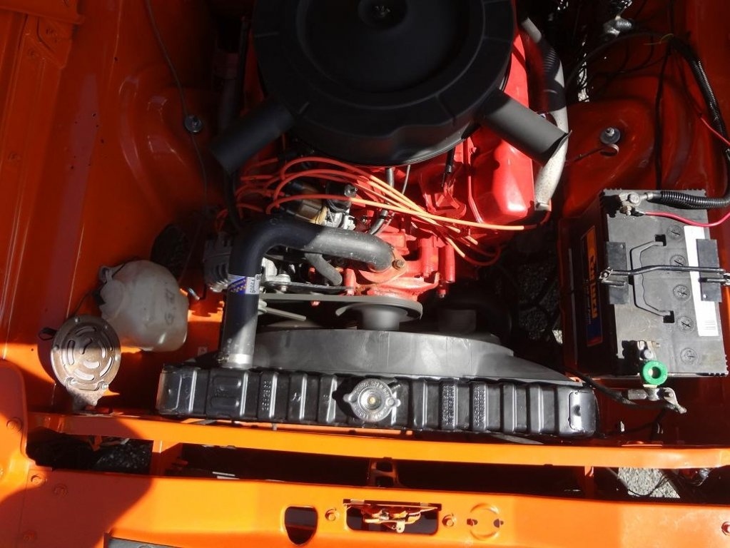

Didn't like the alloy rad my car came with so when I saw that Summit had a Factory looking replacement ,( Spectra ), I brought one along with a shroud and new hoses. A week later a mate spotted a genuine 26" one on NZ's ebay equivilent for $150. I grabbed it. Bonus is that it came out of a 70 RR. Tanks in great condition and great flow when flushed. All fitted up perfectly and runs great. Got a new water temp sender so hopefully that will get the factory gauge going too. ]

Looking pretty muscular with the steelies on Tony. Very nice. Good score on the radiator too.
Looks great! I like the original radiator too.
My car is due for an engine soon too, but for it runs and drives good too. Like you, I just want a little more power. Glad you're enjoying the car!
