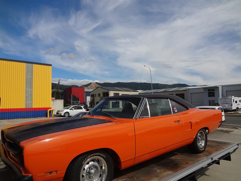

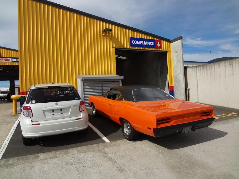

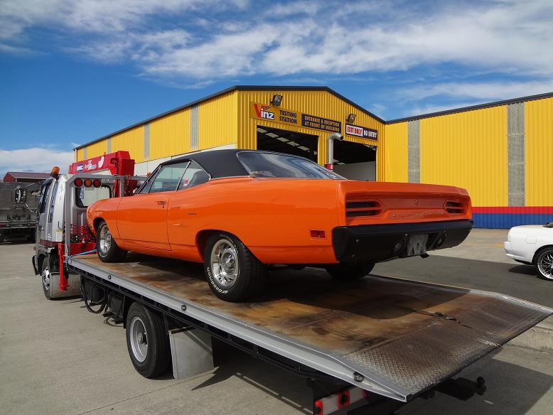

Been an anxious wait the last couple of days . Got the phone call at 4.45pm today. FAIL. I never expected it to pass, was hoping the list of fixes to be doable. Pick her up tomorrow and will have an in depth chat on what needs fixing.
Fails - brake and fuel lines need to be secured better and held away from the body.
- brakes failed because I forgot to remove the paint from the inside of the drums. After they were blasted the operators painted everywhere.
- windshield washer failed to work
- 2 wheel studs were loose
- 1 park light/ indicator failed to work
- Exhaust system was rubbing on the clutch adjustment bolt and muffler touched driveshaft when rear of car weighed down.
More info tomorrow. All fixable so happy.
Thanks for the support guys, good vibes always help.
