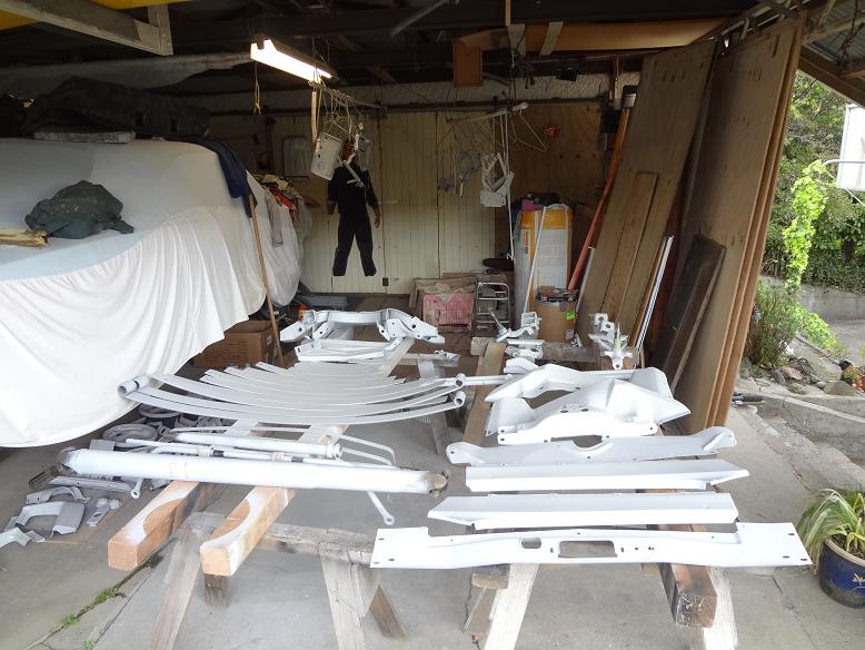

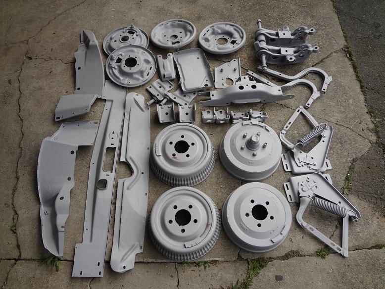

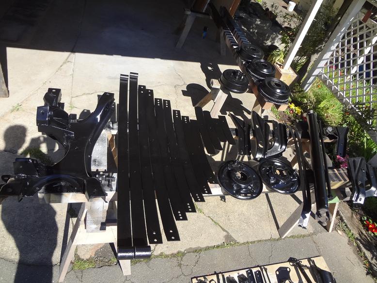

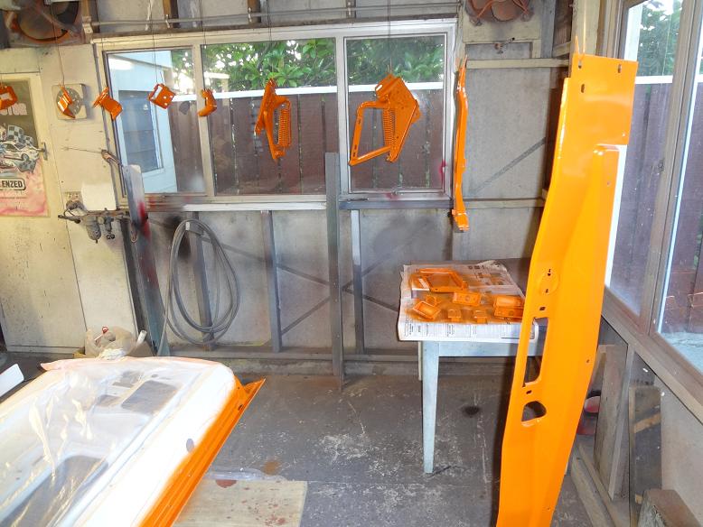

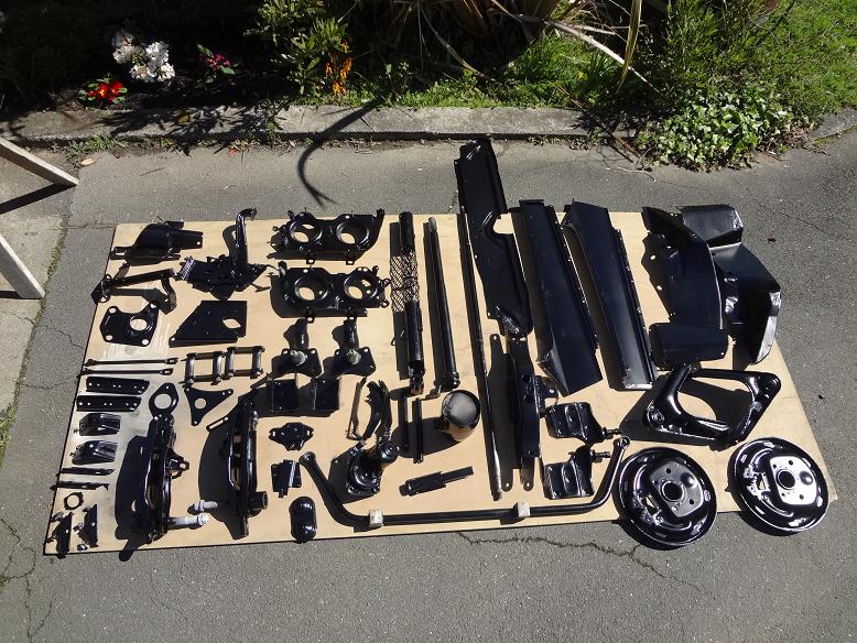

parts painted

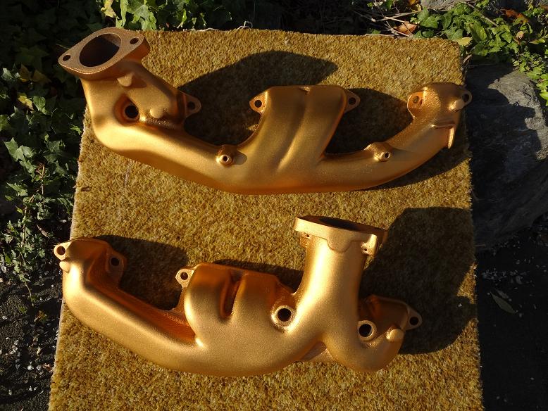

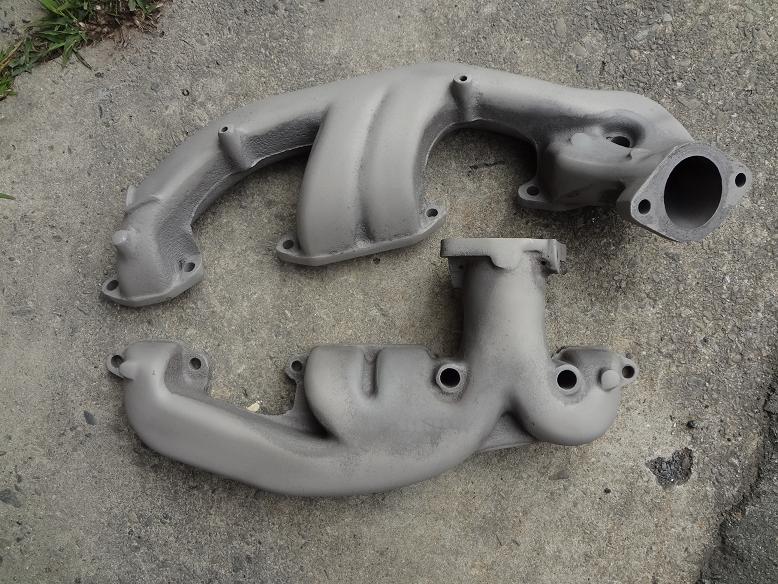

Got parts back from sand blaster all clean and etch primed. Got these and all others epoxy primed on Sunday. Fine day yesterday so got them all painted black. Exhaust manifolds where just blasted and then I put a coat of metalic paint on them. The gold will burn off and slight metalic sheen.

looking very good there ,looks like you had a very good day and got a lot done :headbang:
Holy smokes! Talk about going to town, i thought i had a decent day today, im afraid ya got me beat!!!

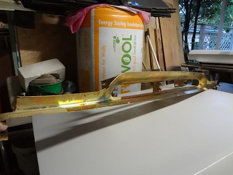

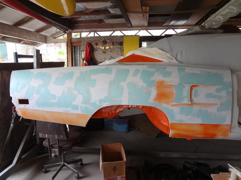

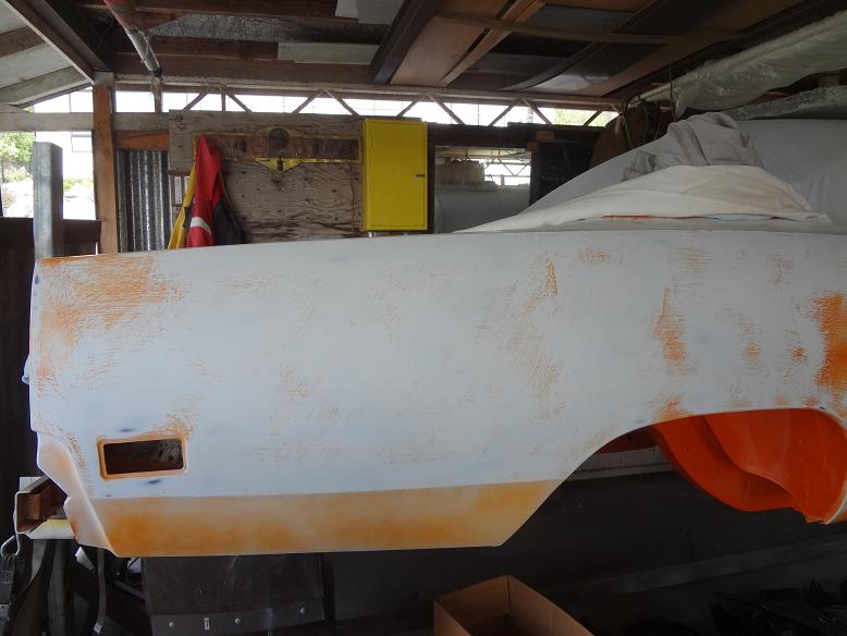

guide coat
Thanks for the feedback fellars, I had done alot of prep work before the big paint Ron.

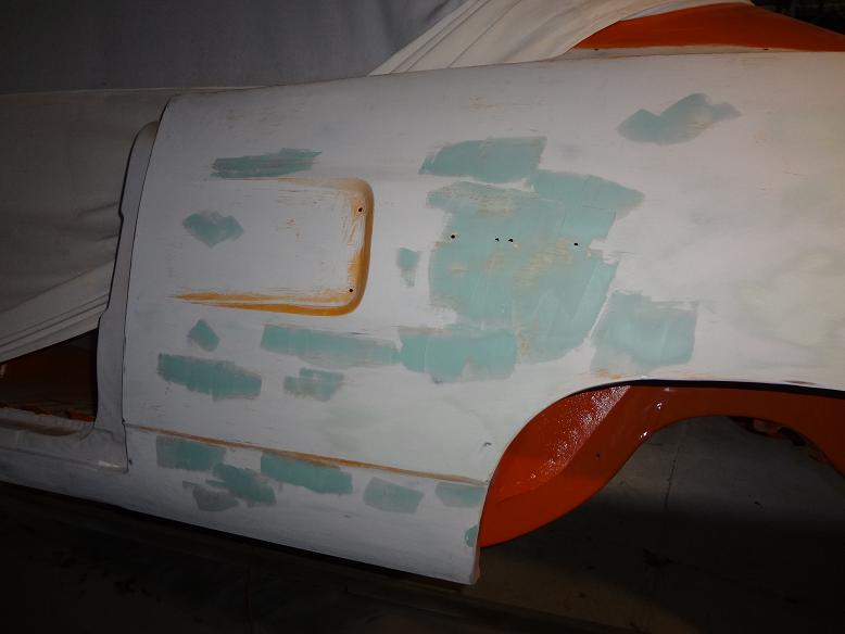

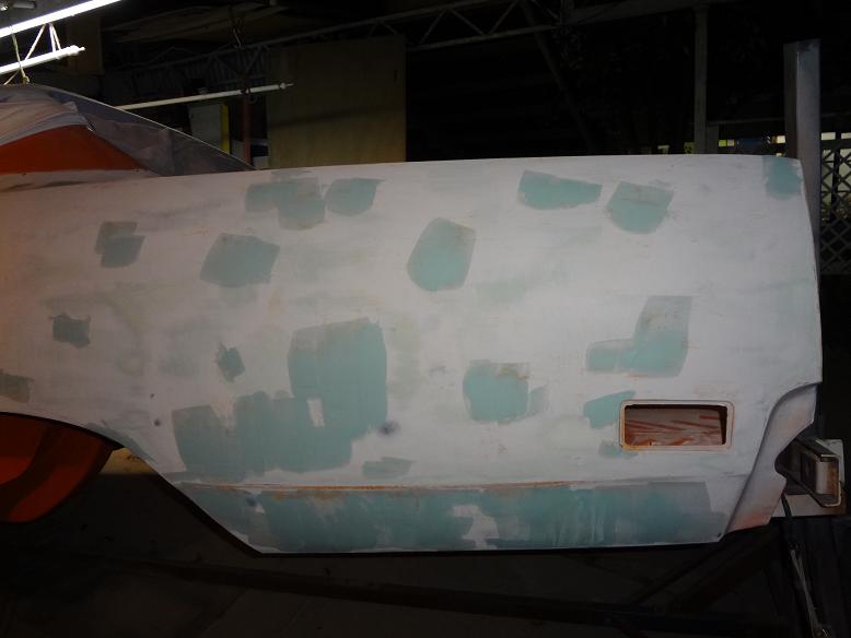

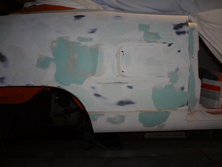

Started sanding the guide coat on the brand new quarter, showed up a few minor imperfections.
Gave it a light skim of fill , sand soon.

I bought two new quarter skins that the guy who delivered them gave me a call one evening after i had my shower and was calling it a night and was going to be here in 1/2 hour which he did about a quarter to eight that night gurr lol and had numerous body parts i ordered from AMD and i think it was Shermans, entire floor and trunk pans ect.. I was whipped and didn't think and accepted them and there is a couple of those imperfections i found the next day on the quarter skins but was told i should have inspected them before they were taken off the truck, my bad and now ill be messaging at least one myself! You'll get it going by all you have done to date im sure!! i guess its all part of the fun :) Good luck...
I feel your frustration Ron.
I am happy enough given that the quarter has had a very long journey across half the world to reach me. The imperfections are only 1 or 1.5mm deep, I am just being fussy.
Fill
Sanded the fill then re-applied . Only minor low spots remained.

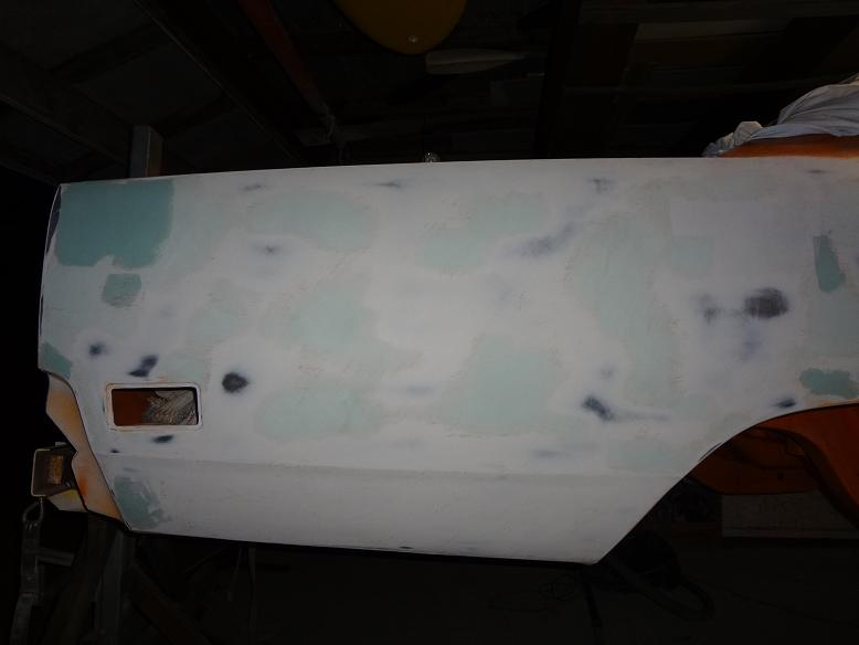

Got to the driver quarter today. I had filled it a few months back. Sanded up great , just needed minor re-skim. Hope to sand tomorrow then get both quarters epoxyed.

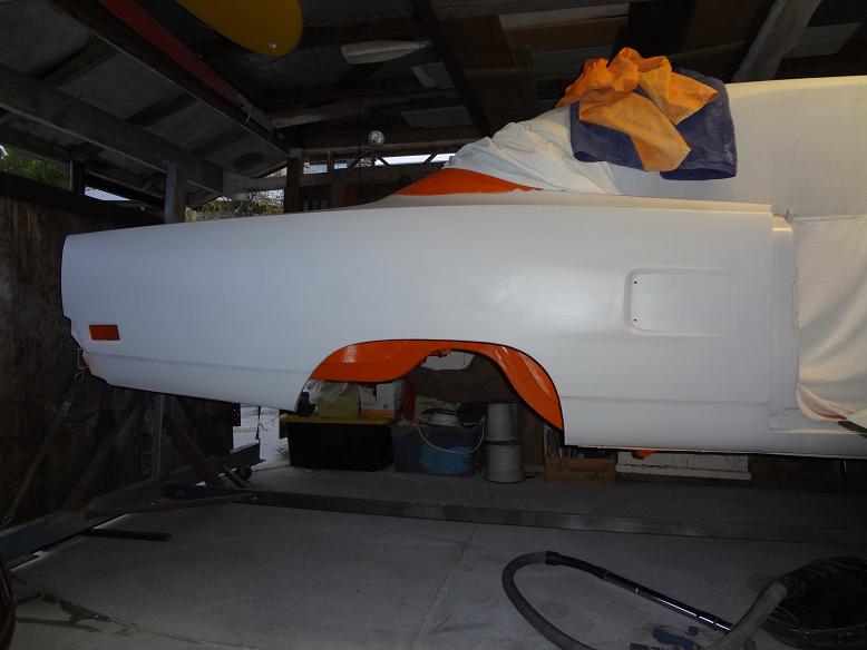

Have made some great progress , warm weather has been on my side.

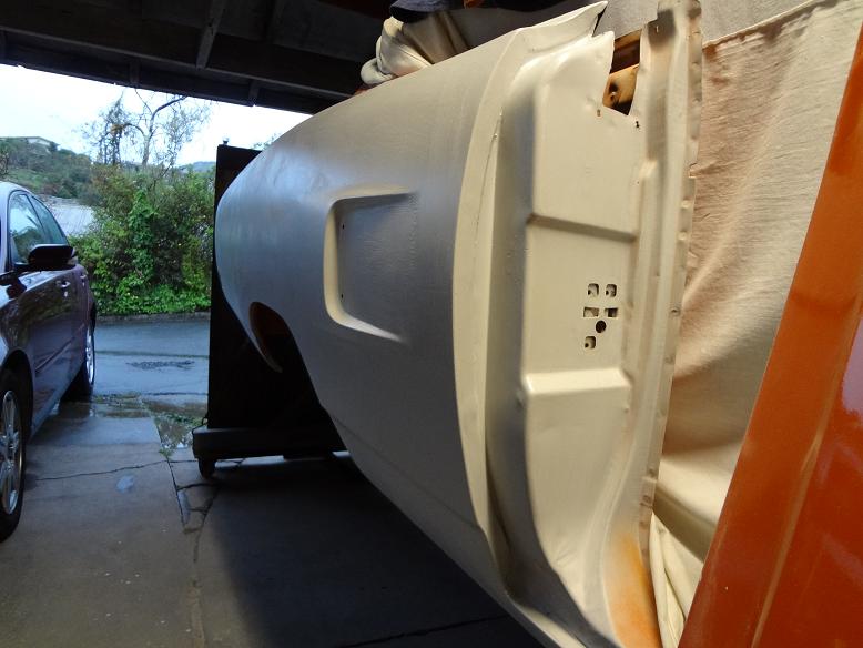

Quarters have 2 good coats of epoxy ready for final sand. Have got the trunk lid ready as well, and have started on the doors.

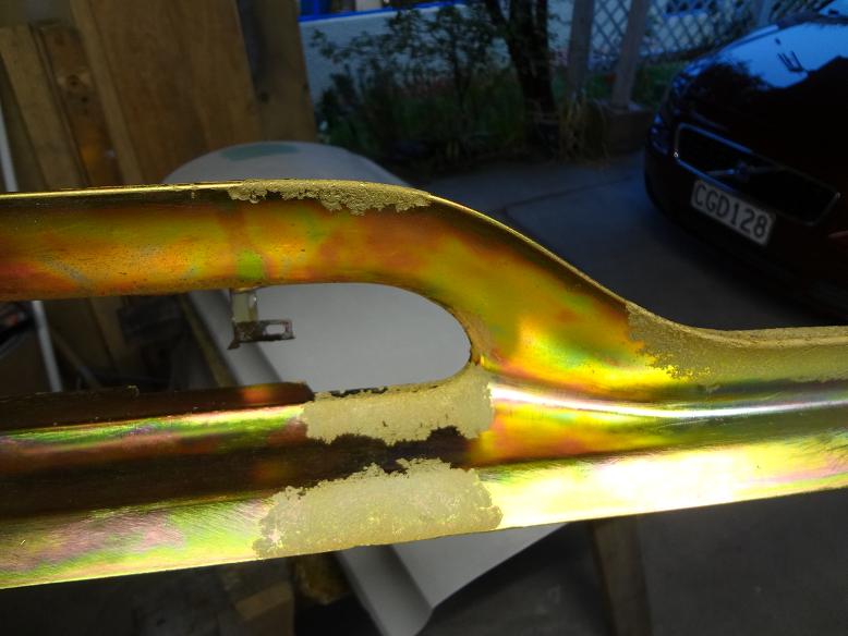

I had the front valance acid and galv dipped. Was very thin in places, needs one end re-placing.

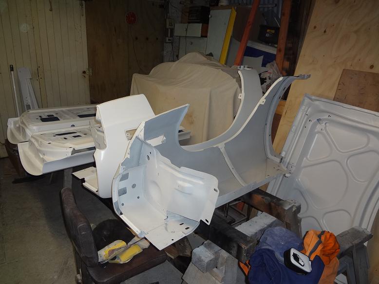

more epoxy

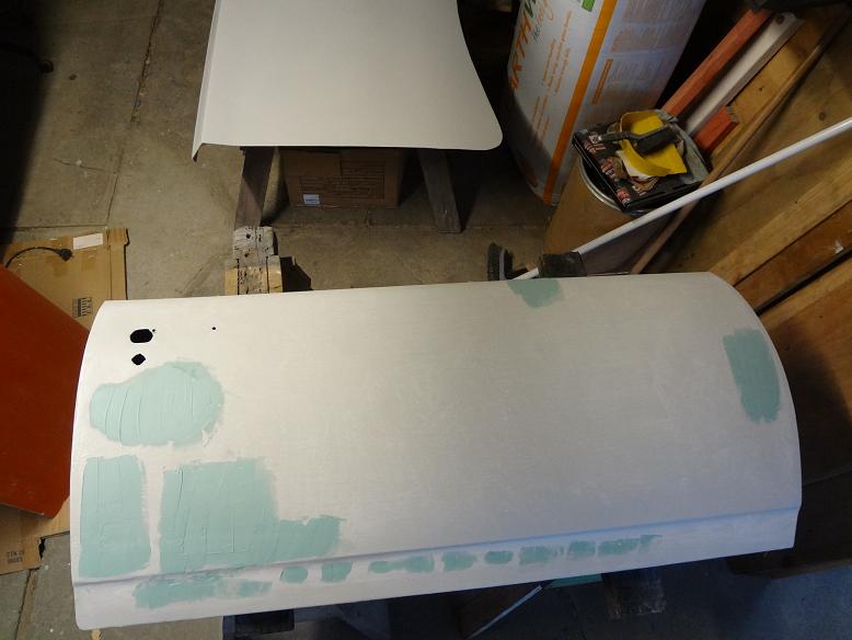

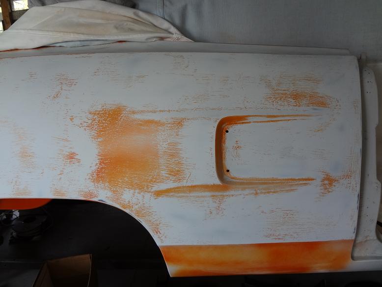

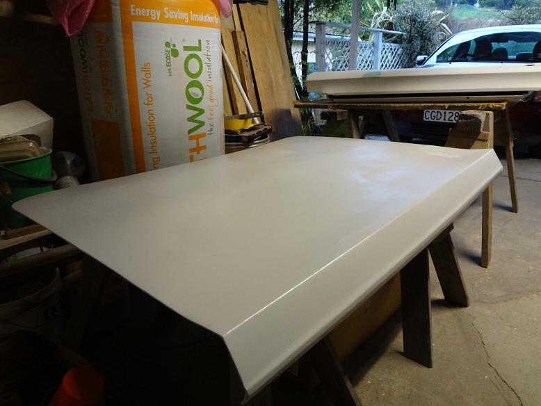

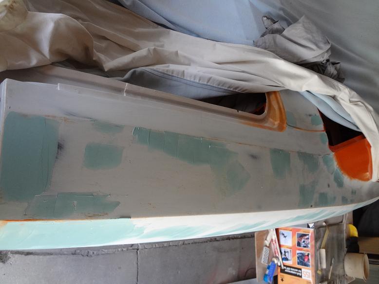

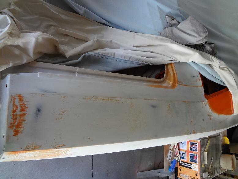

Been done lots of sanding and some filling. Got another 4 lt tin of epoxy primer, in white this time.
The passenger door sanded up real well, driver door needed more fill, mainly at the bottom where we welded in the new strip.

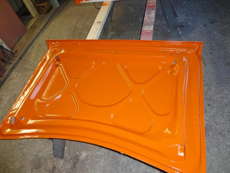

The guards came up nice with minimal filling. I looked at the trunk lid again and realised that the inside needed some work, more fill and sand.

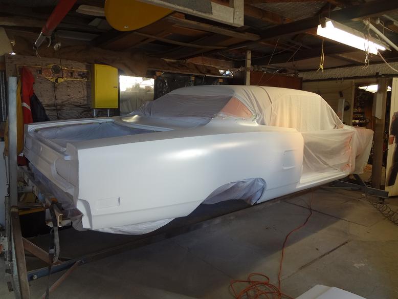

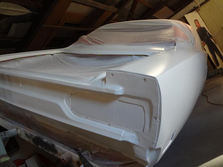

Gave all these panels 3 coats of white.

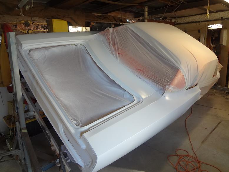

Sanded the quarters with 100 to 180 grit paper, came up real nice. Gave these 3 coats of white yesterday. Will get the car out in the sun to help the paint harden , the guide coat and sand next week.

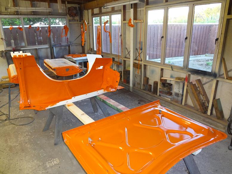

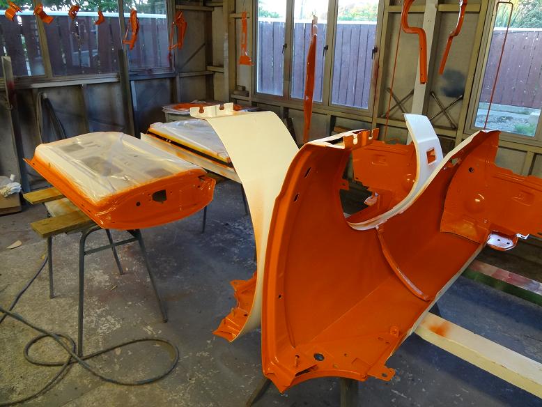

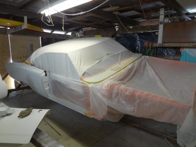

Reward for all the sanding Propwash is I was able to apply more color today.
