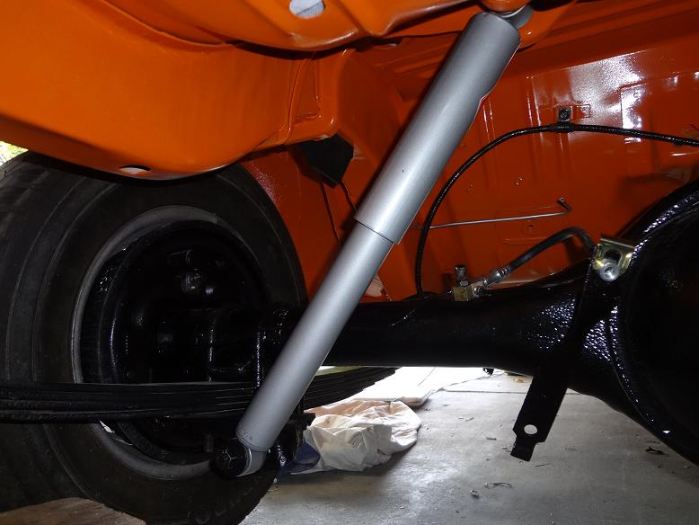

Giday mate, once I start something I find it hard to stop, must be my "boom or bust" attitude. Yes am proud of what I have managed to do so far, surprise myself often. Must post a photo of my shed/carport and you will see the mess I work around. I have been doing the clean /paint as i need lately also. Want to put the master cylinder in but its not painted yet. Have got the rear brakes in, shocks in , pedals in.

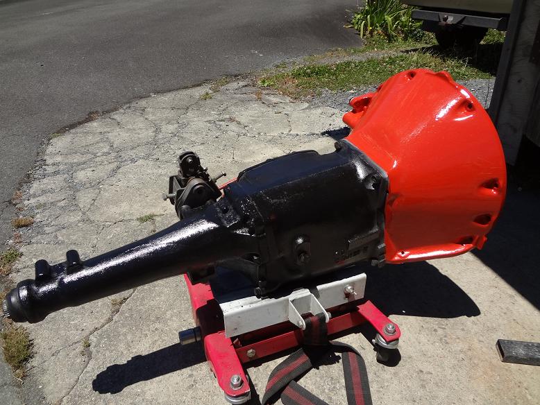

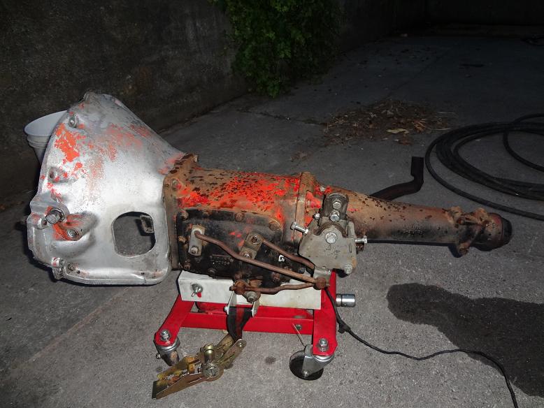

Dragged the A833 and bell housing out and gave them a dame good clean, now looks presentable to reinstall. Thrust bearing may need to be replaced so that will slow me down damm it.

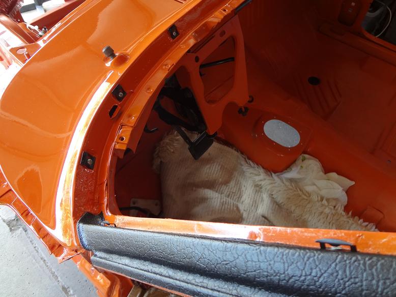

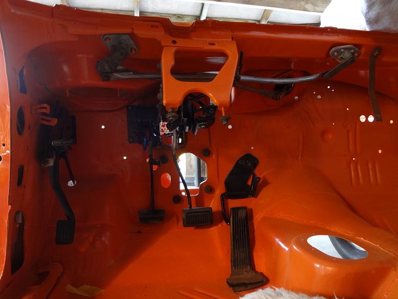

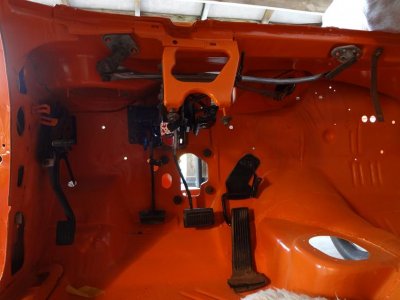

Wow that looks good, you must be one happy builder seeing it go back together. I can't wait till mine is there. Should the accelerator pedal go in before the carpet? Mine never had carpet when I got it but there was a piece of the carpet under the pedal.
Thanks for the heads-up moparjohnny will do that tomorrow.
My keenness to put the car together gets the better of me Bigblock61. Car had no carpet and I have not purchase one but plan to put some type on black carpet in. Will redo the pedal then.

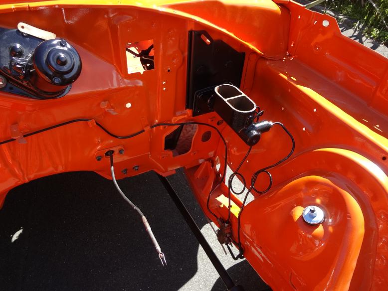

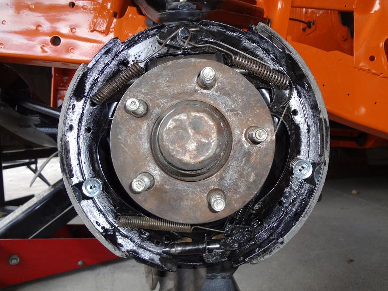

Master cylinder and brake lines nearly there.

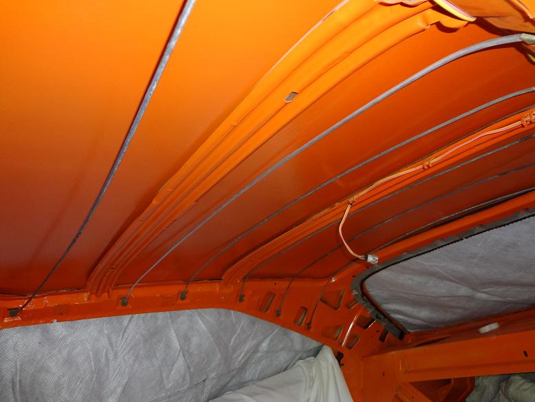

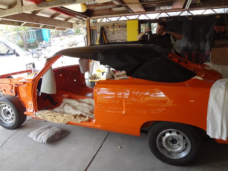

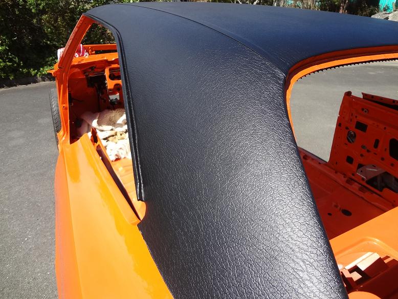

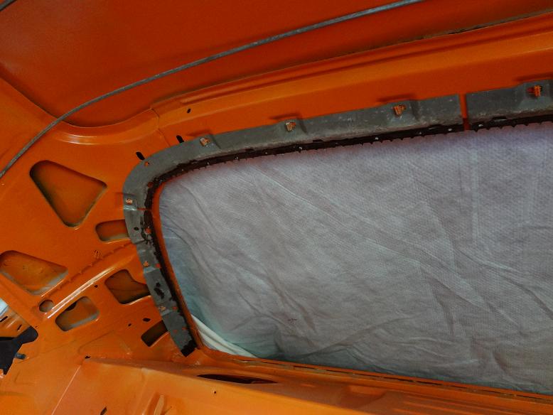

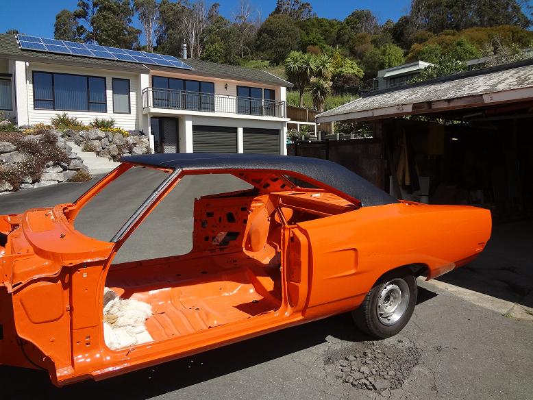

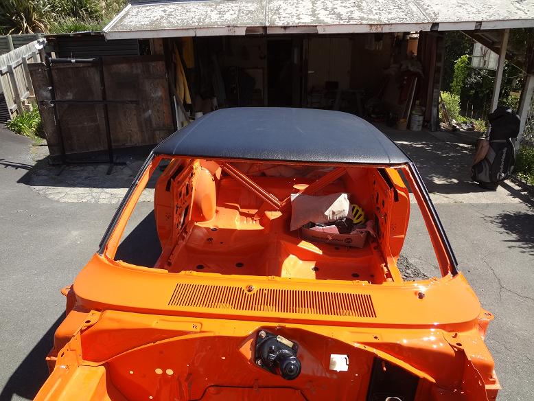

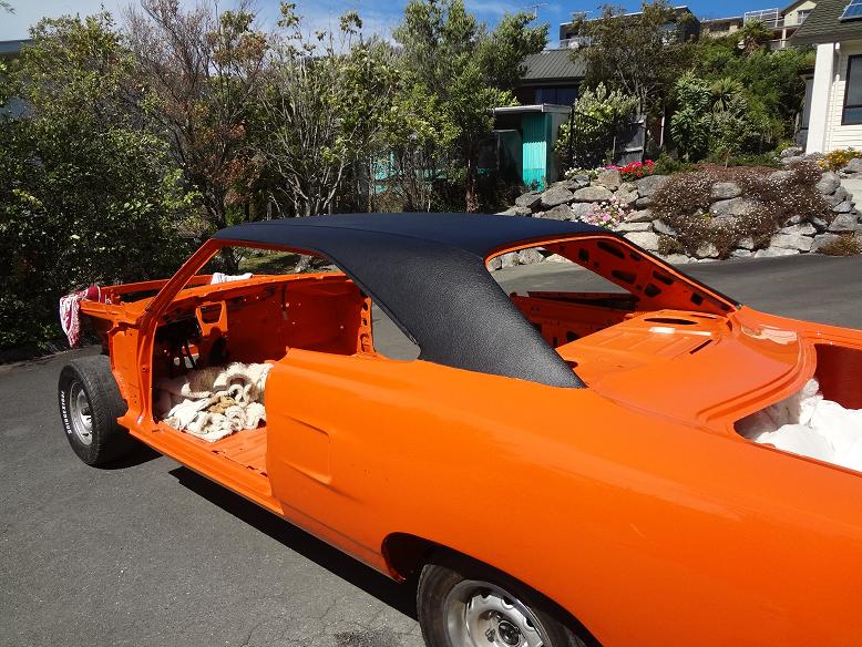

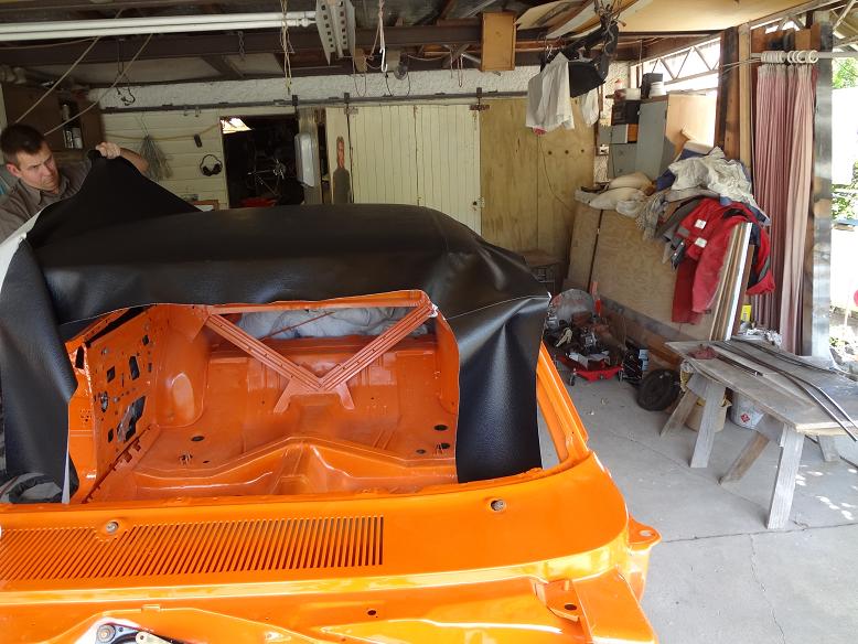

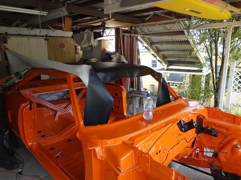

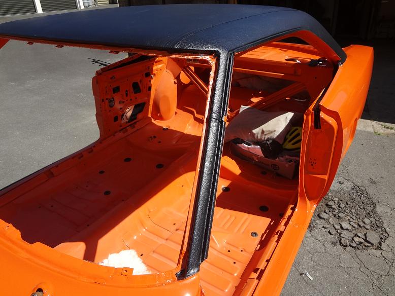

Major step with the Vinyl top going on today. Called in the same pro who did my challenger and he did another fantastic job. Hope to get some trim on tomorrow.
vinyl

Your car is really looking sharp. The vinyl top really adds a touch of class to it imo. You are right about Jeff being a stand up guy. Wouldn't it be great if all vendors would be as accommodating and honest as him?

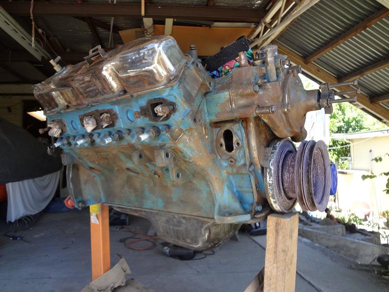

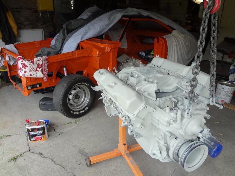

Trans painted, Engine primed and awaiting paint.

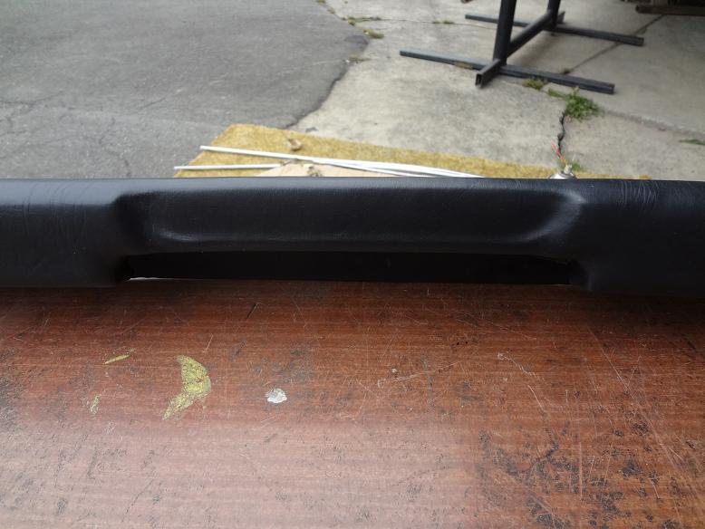

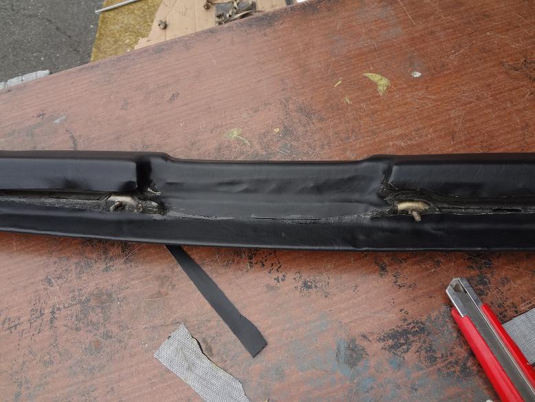

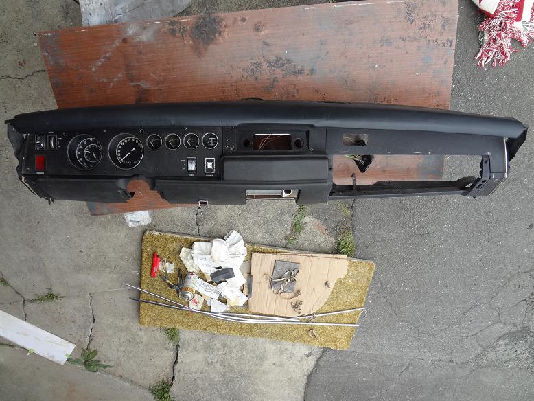

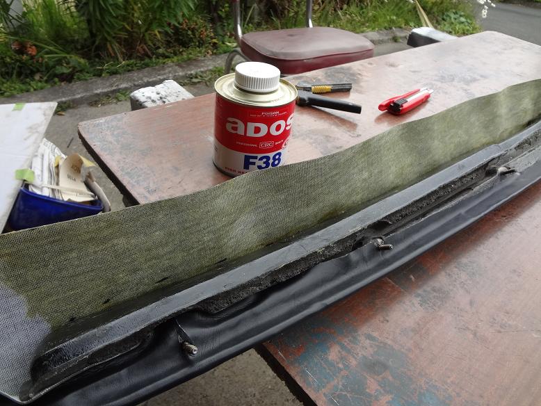

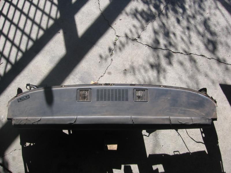

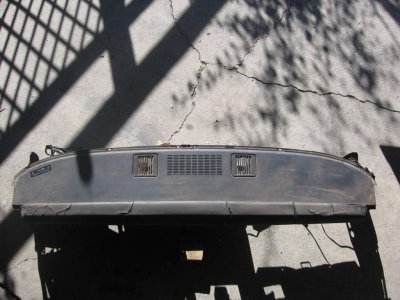

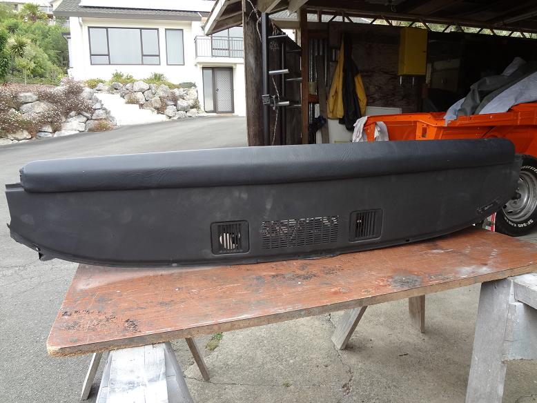

Have been repairing my dashpad. V-ed out the broken sections, filled with Expandable foam out of a can, cut and sanded smooth. Decided to cover this with a 1mm bit of hard plastic to firm it up, glued it down and feathered its edge. Today I glued on the vinyl with an excellent result. Time will tell if it holds up to the sun, if not will get a repo one from the USA.

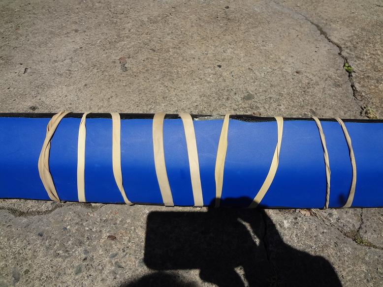

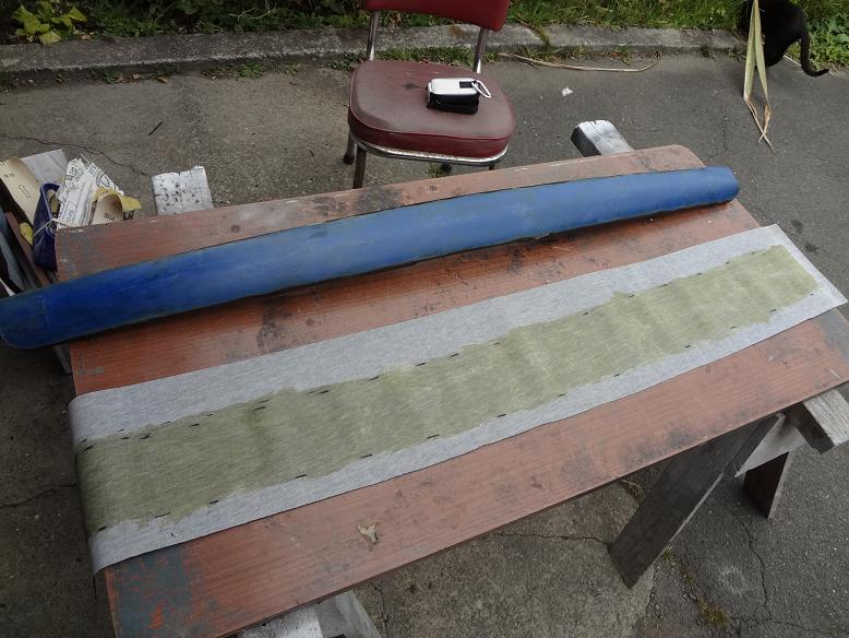

Made a replacement hood bow.
Before dash.
New bow is 2nd from left.

Excellent job on the dash pad Tony. Looks real good. Well done on the bow too. :eusa_clap:
As always, nice work NZ. You did an excellent job on that dash pad! Be it most cars going for resto have a dash pad that looks like a dried up river bed, I'm sure a lot of guys would wonder how you did it.
Your top and the dash look fantastic! The work your doing to this is outstanding, i would love to grab that 4-speed, mine needs rebuilt :( but a long way from really needing it lol, I hope i can smile when i do need it :) And im sure of that.. Keep up the great work, you'll have some neighbors that's going to be a bit envious with that one!!!
