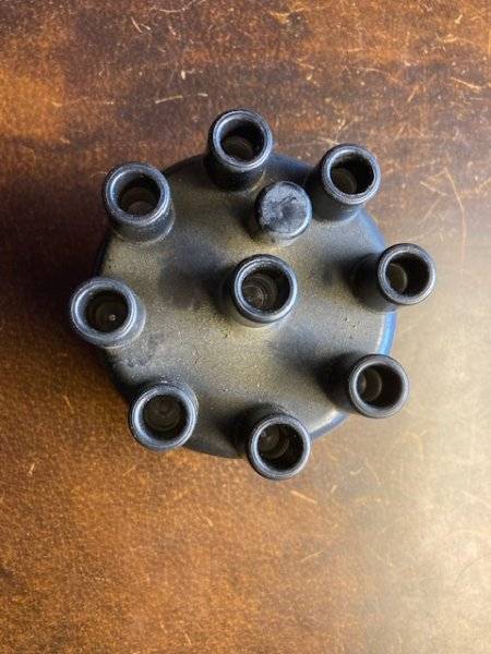

Recently replaced ignition parts on my 66 383HP Charger including the pictured black cap. Never seen one with a breather. Standard brand I believe. Anyone else seen these and have an explanation why it would be needed? Pertronix electric ignition if that matters.

The vent on the pictured cap is to relieve buildup of ionized gases, from the arcing of the rotor tip to the cap contacts, inside the distributor. The addition of the vent to replacement caps started in the 1980s.
Breathers on distributor caps are common, they started appearing way back in the 70's as the energy delivered by ignition systems increased there was issues with high voltage causing ionization of the air trapped under the cap.... To be honest I don't understand the physics of it but here's a link...

Basically the manufacturers were fighting ignition misfire issues and venting the cap solved it...

Holy Moly. I can create plasma in a distributer...and ions, atoms, electrons??? The 70's were different times. Maybe this theory came from some guy smoking something at the corner of Haight and Ashbury. Seriously though there must have some data that led to this. Maybe electronic ignition systems don't have this issue and they generally started in the mid to late 70's. Thanks for the explanation though. Like I say, never saw one before.

My 95 Caravan had a OEM cap with the vent. Went a very long time. Subsequent caps had no vent and never made it past 10,000 miles. I learned to wash the ionized deposits off and dry them out in the oven. Got to the point I could immediately tell when it was time to change the cap and always had a spare with me.
