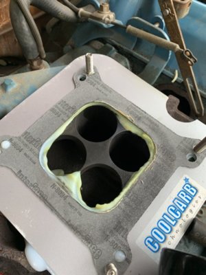

        Classic heat soak. Block off exhaust gasses into the intake, lower float level as much as possible, and add a spacer (insulator) under the carb. Or go EFI. One thing is for sure, DO NOT use Cool Carb Technology spacers. Ask me how I know about this.

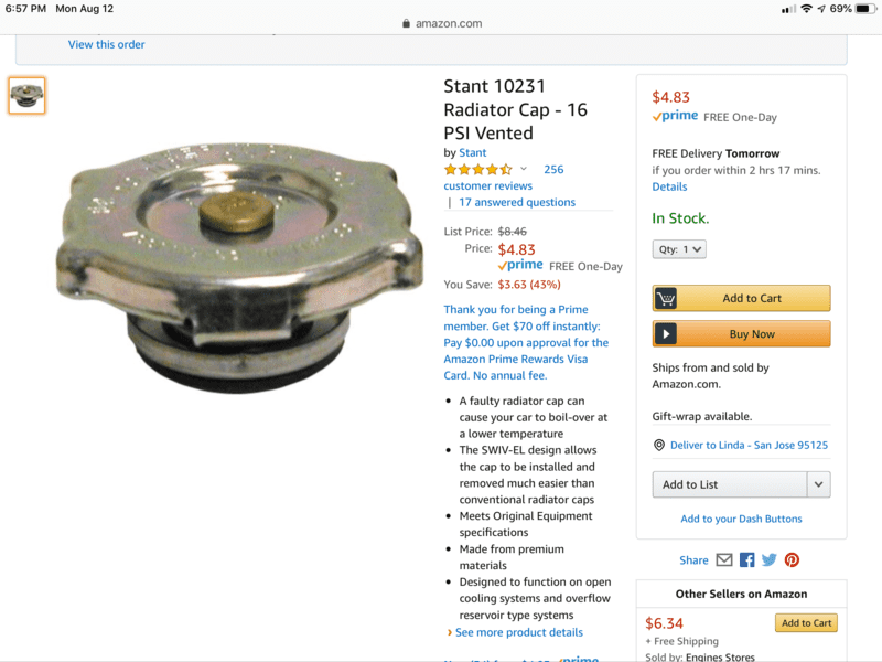

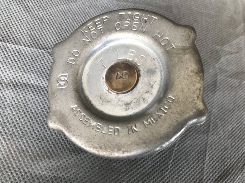

            7 pd rad cap ok for my application ?

              Thank you. Do you think 7 would creat a problem ? Im ordering your spacer. Did you have similar problems before install and did you notice quite an improvement ? I expect to, but like to hear your experience too.

              Mike answered you question.

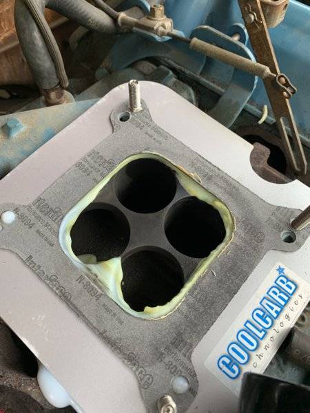

              I acually took every precaution when doing my build to safeguard from detonation to excessive heat. I knew the problems that useing 10% ethanol can have on a carbureted engine and I'm useing two carburetors.
              Kept my compression ratio under 10:1 Useing as much timing as it will take, 16* BTC all in at 34*
              Blocked off the manifold crossover to eliminate any exhaust heat under the carb.
              Used the spacer under the carb.
              Used foil insulation on the fuel line in the engine compartment.
              Used ethanol compatible rubber fuel hose.
              Constructed a good cooling system, new radiator, good fan with a shroud, (one third of the fan blade showing out of the shroud), eight blade water pump, 180* Super Stant thermostat.
              I'm only useing enough antifreeze to protect it to around 20 degrees. Water displaces heat better than antifreeze. I have tried Kool It and Water Wetter. They do work. I'm only useing distilled water.
              I'm running 93 octane, 10% ethanol during the summer months and I'm adding the Stable 360. In the fall I'll fill it up with ethanol free and keep it topped up for the winter storage.
              The engine runs at 180 deg whatever the outside temp is. Hottest I've seen it was 200 deg in stop and go traffic, 90 degs outside and the backup was over two miles long. Placing the trans in neutral and running it at about 1000k, it would drop down to 190 deg. Circulating the trans fluid in neutral helps as much as circulating the coolant when sitting in traffic.

                Thanks guys. I ll order that cap, Dennis
