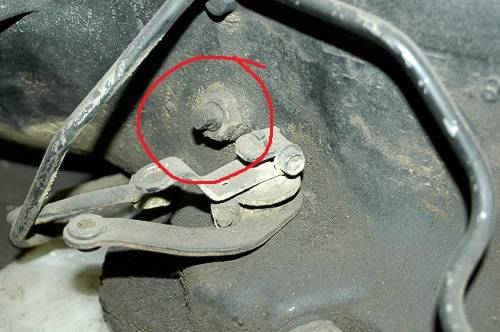

This is not the transmission just showing you what is leaking. I have the NSS ordered but trying to figure out how to seal this nut up. Thread sealer?

I finally got the trans to stop leaking. I replaced the NSS and its all good now. There is a drip or so coming from the band adjuster but I'll deal with that later.
