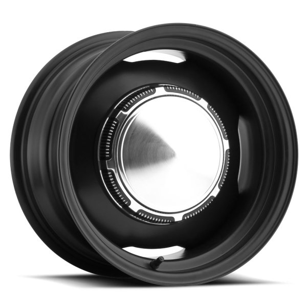

Any companies offer this OE style steel wheel in chrome? Or is my only option to purchase and have chromed? I've only found 'smoothies' and other similar but not exactly what I want.
Hoping to pair some w/ Cragar SS's on the front...
Thanks for any guidance.
Check Speedway Motors. 4.5 bolt pattern CHROME 15x7 #250-205712 or 15x8 #250-2055812 both have 4.25 backspace,center hole is 2.840. I checked and they will work for Mopar axle hubs such as the 8 3/4'' axle.
They call them "Hot Rod Wheels. Old school chrome with cap lugs like the old days.
I planed to use them when building a Gasser. Sold the car before it was completed.
