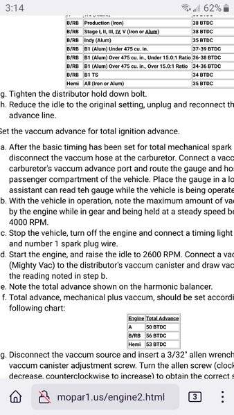

This is the HotRod article MoparLeo provided.

HI MWFan... If you look at Part F of the photo in post #28 It say's
"Total advance , Mechanical Plus vacuum advance"
How can it be all in when its NOT all in without the vacuum advance?

Vacuum advance is in additional to any advance from initial and mechanical. You set TOTAL for what WIDE OPEN THROTTLE would represent, which should NEVER have vacuum advance involved in real world applications.
You also can't pick a rpm number out of thin air and say set timing to 36* at 2500rpm. What happens if the distributor has 10 more degrees in it at 3000? Now you have 46* total... which is not going to be good for most any engine with todays pump swill. You MUST find the point where the distributor is no longer advancing. That is the RPM where you define and set total timing with vacuum advance disconnected. Seen plenty of distributors not stop advancing until over 4K including MSD's OOB with the garage door springs on them causing issues.
After you get the initial and mechanical sorted out, you tune the vacuum advance for your application. Some cars can handle vacuum, some can't. Depends on the build and if you can actually get the fuel system to get lean enough to benefit from the additional timing. Lean mixtures require more timing.
I disagree with plenty in that article on setting timing. Total timing method is a horrible way to set up a street car. Think building a house. Do you build the walls or roof first, nope. The foundation of the timing profile starts with initial/idle timing. You build from there. The cars were initial timing crutched even in the late 60's with emissions requirements. Stock 318's like 10-14 idle timing. How do you think an engine with a bigger cam would like 5* as that article suggest as a starting point. It does have good explanations, not so good on real world settings. Bottom line, if you have the idle set and you give engine more timing and it increases RPM, it likes the timing.

Total advance is initial timing plus Mechanical advance in the dist. only. Vacuum advance isn't available under wide open conditions because there isn't any vacuum to operate the canister. Vacuum advance is only for part throttle cruising when the engine is producing vacuum and needs more timing is complete the burn.It needs more time ( advance) because the cylinders mixture is not tightly packed, it takes more time for the gas and air to find each other and party. Under wide open conditions the cylinders are packed full of gas and air, the flame front travels fast meaning there is not a need or desire for additional timing. All timing procedures should be done with the vacuum advanced off and plugged. I would also think you wouldn't want to see more than 48-50 degrees with the vacuum advance kicked in , remember truth is you really don't even need it so why allow the vacuum advance to run it up too high and possibly hurt the motor. If the arm on your vacuum canister has a 8 stamped in it that means that it increases your part throttle timing by 16* ( crank degrees vs. dist. degrees) hope this helps.
Good point here ^^, and rarely mentioned. Both the vac can and the the mechanical limiter have these numbers. They are always in distributor degrees, just like the distributor specs in the manuals. These vary a huge amount between different distributors. I’ve always used junk distributor parts to mix-n-match to get the mech and vac advance I want.
