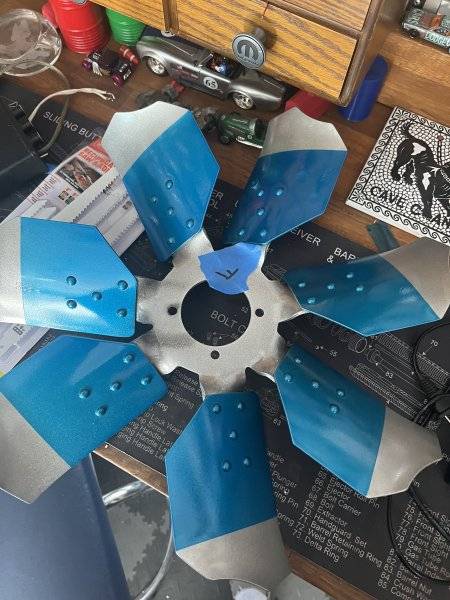

Offset fan vs regular fan

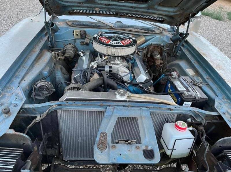

how close is the fan to the radiator?
No shroud I would want it closer. You are going to have to run it . Add a mechanical temp gauge to see real temp,Factory might be off. I have both on my Bee for temp. HOT in SC

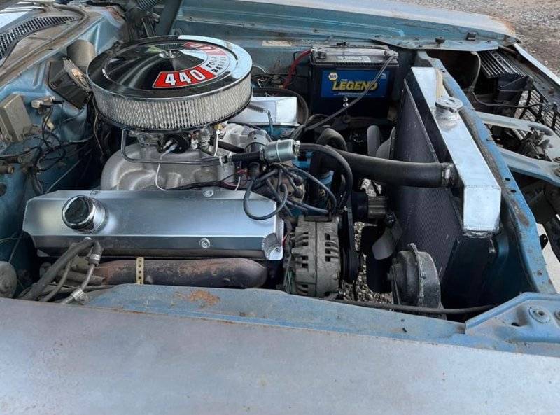

Duel carb, edelbrock heads, new radiator as you can see, we bought the car like this becuase the guy was turning it into a hot rod, and so am i.

None of my gauges work exexpt my spedometer i need to fix them but not my main priority. Alright ill drive it tonight alittle harder then normal and see if she runs better or worse
About 3 to 4 inchs, same as the fan before
You should investigate buying and installing a shroud and position the fan a minimum of half it's thickness inside the shroud. Without a shroud going closer decreases the surface area the fan utilizes; too far away causes even less CFM thru rad due to short circuiting air flow around the blade tips.....yes get a mechanical temp gauge...

Definitely ran hotter, i am going to switch it back when it cools down

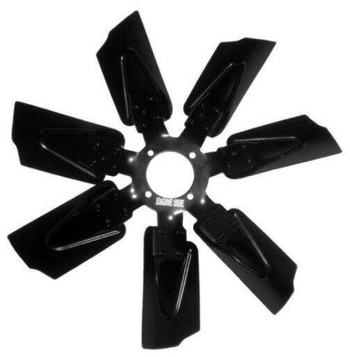

looks like 7 blade fan for you car

Good to know, if i went with the 7 clutch fan how much would i be looking at plus the spacer?
looks like 7 blade fan for you car View attachment 1466479
This is a Mopar original design fan to be used with EITHER a thermal drive or torque drive fan clutch....a good choice...Tony's parts has both clutches and the mounting hardware. Your radiator fabricator should have or recommend a shroud to fit his design....just my opinion..
