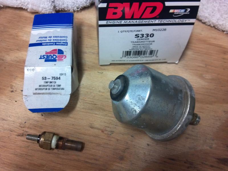

is it possible they gave me sending units made for 12 volt system not 5 volt? and would that make a difference.

bet you got wrong senders....pic of senders you have here would be helpful
used sensor thats I took off look to be only few years old, but the gauges didnt work when I bought car, the new ones came in boxes shown and look just like old ones.

do these look like correct part numbers and type of sending units anyone has used with good results

is it possible the sending unit is for 12 volt system?
that was original question. if the sending unit in the picture looks like right one.
