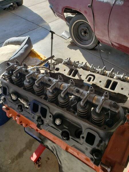

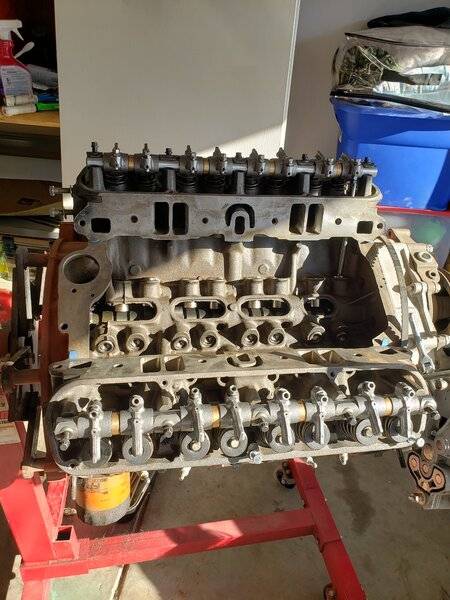

The pan is on. And the motor is out I had to remove the heads to have some work done on them and they have been off for about a year. I blew out the pistons and lightly coated the walls. Just torqued the heads back on today.
Pics
