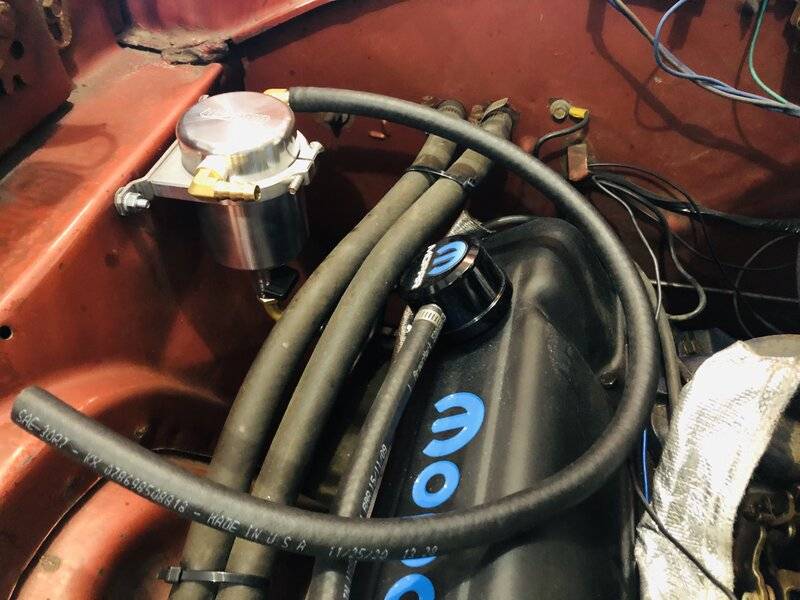

Took out both rear header bolts - added plumbers tape and permatex - those seem nice and dry.
Ordered a Wagner PCV setup and should be here tomorrow - vacuum gauge reads 15 at idle. Hoping that crankcase pressure eliminates the “seeping” oil leak I have. Also installed a Moroso Air/Oil Separator - just waiting for the Wagner to arrive to complete setup.
