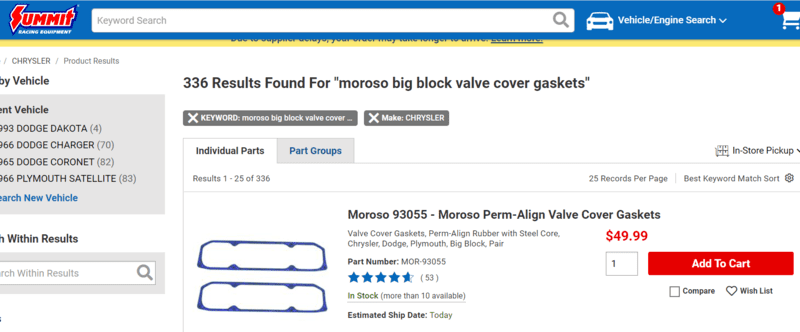

I used these with some RTV in that spot:
