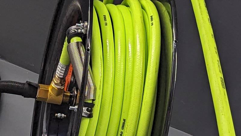

I have a pretty big system. Ingersol Rand going to 4 Flexzilla spools. No oil is being purposly introduced. Regulator only.

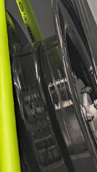

Very recently I noticed a very clear oil all over the lines on the spool. Honestly all 4 spools to some degree, some more than others. Its a "glaze" of it. Also its on the black base of the spool too. This is about on all of them to some degree.

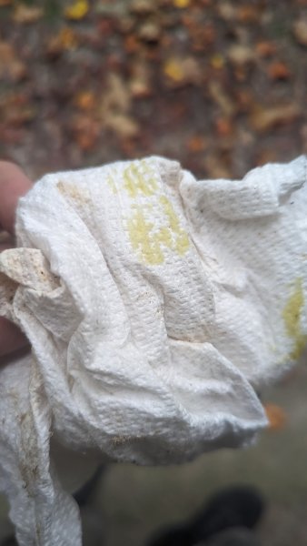

But when I check the compressor the oil is still quite full and very very yellow. If i barely even get a slight glaze of it on a paper towl directly out of the compressor it shows bright yellow.

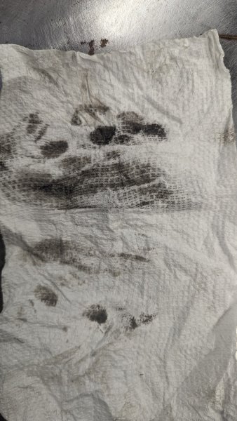

But if i wipe a paper towl along the affected lines in my shop it does not build up with even the slightest yellow. If anything it is just dirty like i'm wiping lettering off or grime.. The oil seems thin and clear.

I called Flexzilla company and they said its not possible its from the spool itself.
Seems like the hoses are releasing the oil. Might be something in the materials or process they are made with. Put some dye in the compressor oil and see what happens.

I blew air for a bit in to a balled up paper towl and didn't see any specs or anything. Perhaps I should let it go a lot longer though. I just held it on for may be a minute.

The fluid on the spool/lines very much seems like something that wouldn't dry. its oily. thin, oily and clear. And some how it seeped out on to the spool and out on to the flexzilla hoses! like it just seeped around a lot more than I would have guessed and this is on areas of the spools that never get pulled out. just stay wrapped up in the spool.
