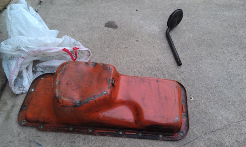

I think I have a stock pan that would fit your car / engine.
I'll compare it to my aftermarket deep sump pan tonight. If it's the correct one you can have it if you cover shipping. I'll throw in the windage tray and pickup tube as well.....
On my 67 coronet, I went from a stock 318 to a '70 440 out of a Chrysler 300. Used the mounts that were on the 440 with no issue. also went with a 6 qt hemi oil pan with no fit issues.
Looks like you'll have to pop out the bottom a bit... It seems to be pushed up "dented" from the previous owner. I never used this pan, just removed it from my 67 440 before my build began..... Anyhow, it seems to be the same sump orientation you would need like my deep sump aftermarket pan on my 67 satty.
