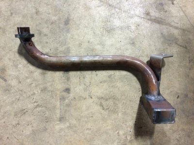

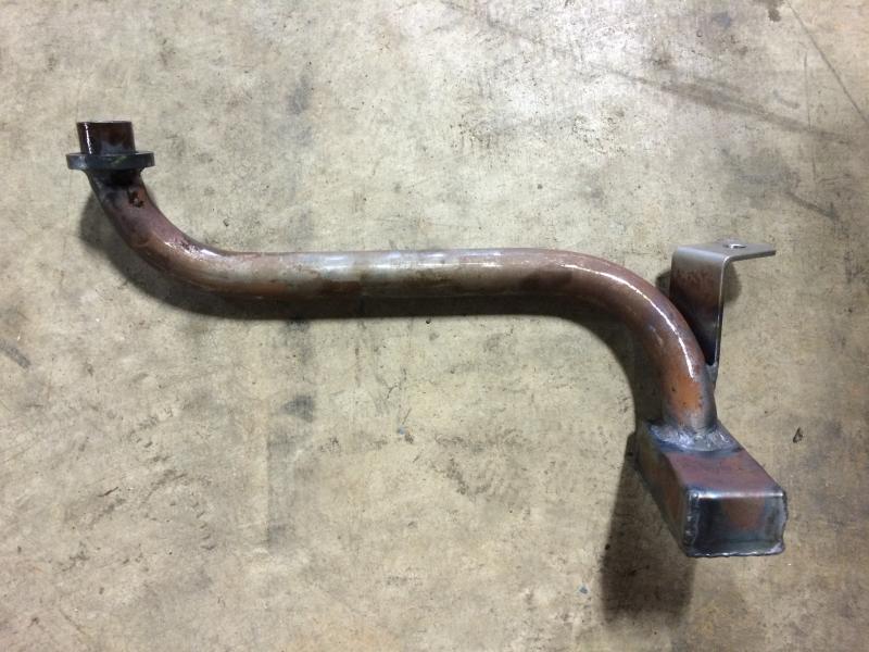

But it did gain me some time to discover that the Charlie's oil pickup won't work. The end of the tube that enters the block (with the O ring) is too long to actually seat, and the angle of the pickup is entirely wrong.
Luckily I had the new Milodon pickup in hand, and it seems to work perfectly. It's also a much nicer looking piece, which surprised me. The Charlie's pickup arrived with surface rust, did not include a new O ring, and as I mentioned, wouldn't even seat in the block. Odd.
Anyhow, onward and upward (once I get my main cap stud!)
Send that pick up back to S&P and tell them to get the their **** right......that pan and pick up isn't cheap!!!!
that pickup looks like crap actually...i'd send it back and get a refund for it...terrible
i used the charlies pan an my pick up tube looked alot better than that one. your paying over $400 bucks for a pan make it right.

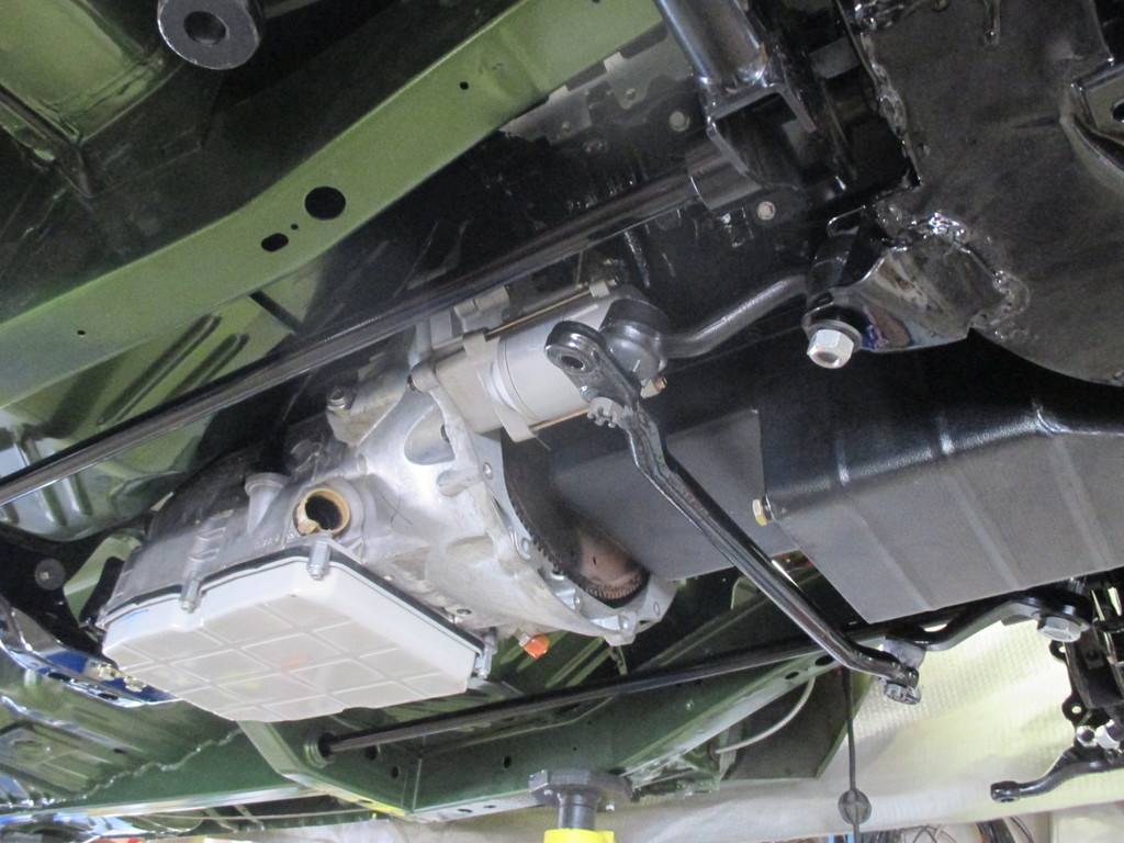

I used the 5.7 Milodon pan and pickup with my 6.4/NAG1. I'm also using a modified stock suspension and stock K-frame, though.
That NAG1 is a nice trans - I just couldn't bring myself to making it fit in my Charger! Your car is so... CLEAN on the bottom. This is why I don't post many pictures of the underside of my '66!
Making it fit correctly, isn't as big a deal as most think. Just lots of planning, very little body mods, some fabbing, and patience. Custom built headers are a must.
