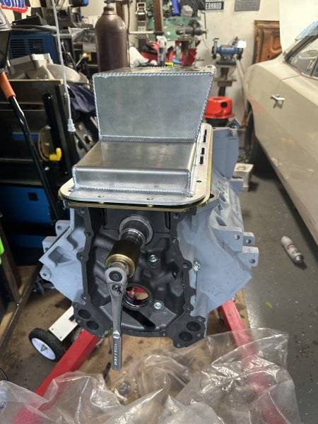

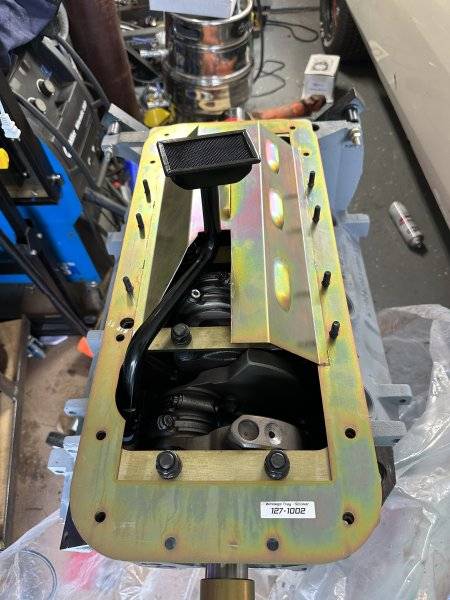

Wish i had this version of the Moroso pan. My pan is an old version, without the notch.

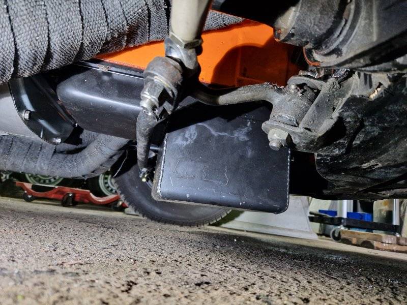

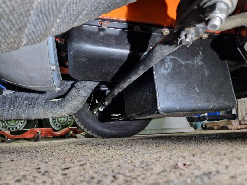

I just installed the other 440 for my 1970 RR, and learned that center link is hitting pan at full turn.
Will have to modify the pan or get a new one.

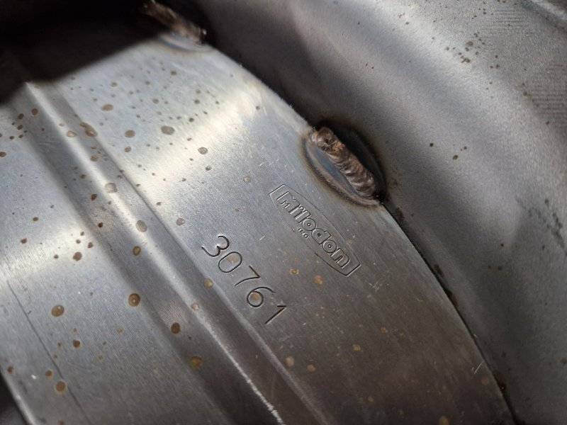

I found out that my other 440 had a Milodon 30761 pan, so I installed that one instead. Problems solved.Wish i had this version of the Moroso pan. My pan is an old version, without the notch.
