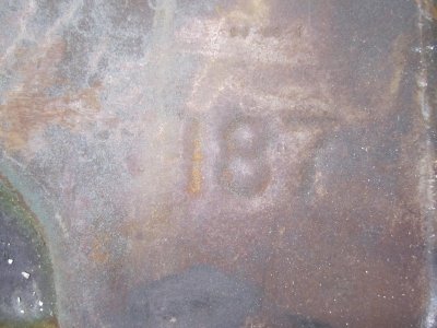

Just a stock replacement. I did find the 402 on the pan, just found out they were numbered

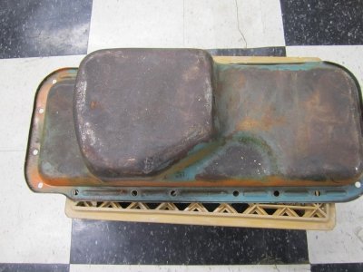

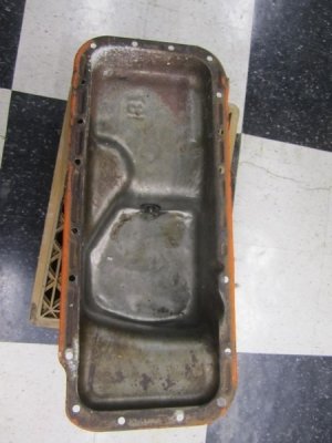

I have an old pan lying around if it helps.
I've also learned the sumps are not the same either. I had a 699 pan and changed to a 971 and had to do some bending of the sump and cutting of the pan to make it work.
