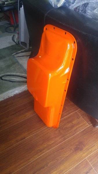

I spoke to the previous owner and apparently it has a Hemi oil pan and a Hemi pickup as pictured. Could this be the issue?
It may be a Hemi pan but not necessarily a Hemi pickup. A Hemi pickup is 1/2” dia and the block would have to be drilled out to fit one. If it was a high pickup you would probably lose oil pressure at high speed rather than at idle.
The oil level will never be higher than it is at idle. Therefore I dismiss the pick-up height being to high or level to low. Pressure is low at idle because the pump moves less volume at lower engine speed. Is the pressure really at zero? We don't know that without trying another gauge. I just helped a guy with a 390 Ford. Same issue. He swapped the gauge, problem solved. Thicker oil would only be the answer if oil temp is extremely high. I oubt that as well. So suppose it's not the gauge. You've swapped filter to a Wix. I would discount the filter as the issue. There is a possibility of the relief valve never closing all the way, though unlikely. Since it has pressure at speed I would also discount any galley plugs not seated or missing. There may be a lot of internal leakage, loose lifter bores, bearings. Or a rocker shaft loose? causing an internal leak inside the valve cover. If it passes all these tests I would put a high volume pump in it. But to be honest I'd bet it's the gauge.
