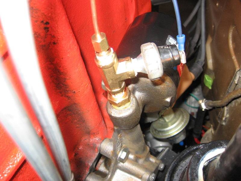

Sure, I have a T in mine for the mechanical gauge & the stock gauge is still there and working just fine.
Even though this was on a slant 6 I teed the light and a mechanical gauge.But you will get the idea.

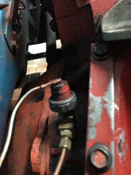

I tee'd mine before I realized that there was another port.
Both the idiot light and the oil pressure gauge (mechanical) work just fine.
