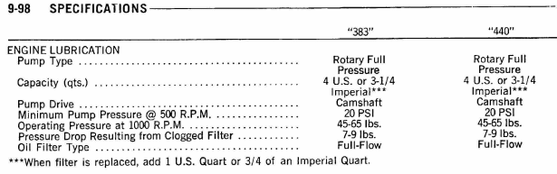

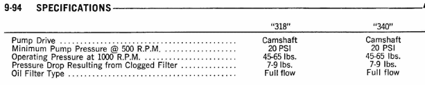

Of course one could refer to the FSM.
An example from the 1970..........
