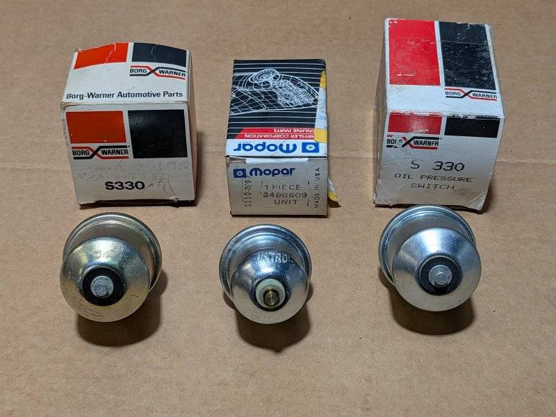

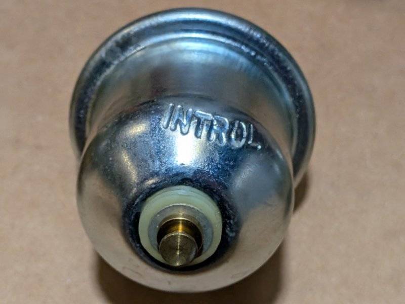

1970-1987 all with gauge is how they are listed. This one happens to be a Filko brand ftom back then.
