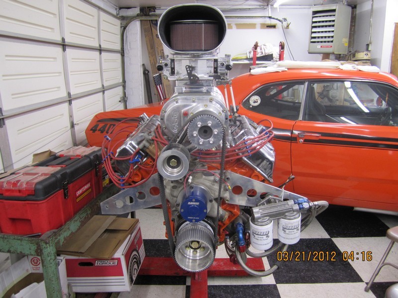

I use Moroso filters,they have No bypass so you know your filtering ALL your oil .

Bypass isn't such a bad deal-on a cold start it allows flow when the oil is cold and thick. Unfiltered oil is better than no oil, or a blown filter medium. Remember-back "in the ol' days" many (most actually) engines had no filter at all, or at best a bypass filter. Filters really didn't start becoming standard equipment until '55 or so-and some engines (235 Chev Six for instance) had only an optional bypass filter until the 1963 model year. On a street motor the bypass is generally a good thing, unless you're pumping sludge, in which case you're already screwed.
