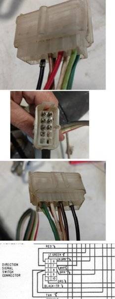

Ok electrical gurus.....check this one out....
Koosh, This is a 69 floor shift column (no orange lamp lead). These is the very reason I take pictures. If you notice the Black, partially inserted wire, it is in the wrong position. It belongs in the opposite empty position. I probably started and decided to take a picture before I went any further.
That is great info! But where is this connector?
The picture shows you where the connector is in relation to the column. The arrow points to a piece of channel which is fastened to the column with small screws and protects the wires.
Thanks again!
Ok fellas, wanted to say, once again, this forum is great for all us rookies......new harness installed----all lights working perfectly!!!!! Thanks for all the help.
