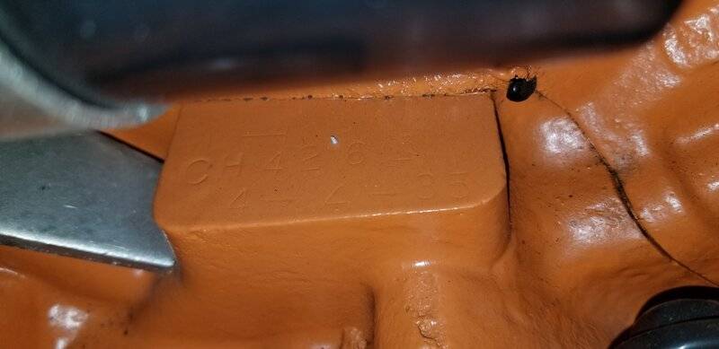

OK, Hemi Guys a question.
Jerry Hall
4:31 AM
Mar 26, 2018
11,622
21,514
Alabama
CH 426 = 1967 426 Hemi
4-4-35 = April 4th 67 maybe what is the 35?
The maltese cross = 10 under engine.
I have not crawled under the car to acquire the block cast date, or pulled the starter to look for identification there. What does everyone think or know?
Maltese cross isn't necessarily -.010. My original engine had a maltese cross but main #5 and 5,6,7, and 8 rod journals were -.001. Counter weight would be stamped if like mine. 35th engine built that day but is a guess.
