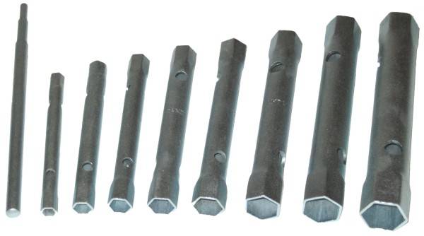

The correct sized tube socket should get the pump in or tighten it up.
But the filter is so tall, the socket cannot reach the nut mate?
Tube sockets are approx 6" long and completely hollow - you need a screwdriver threaded through the opposite end to turn them.
Also known as "Box Spanners"
