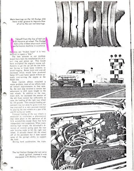

Yep, and I think it was 1963 when mopar went to those bearings and the 1/2" pick-up. Guys were spinning bearings left and right on their big block mopars, chevies and ford's. Ford and chevy went to priority main oiling and 4 bolt mains. Mopar just simply quit on the wedges in early 1964 and thru all their effort at the hemis.Yep,
I remember seeing the wide grooved mains for the Max Wedge....
Some even grooved the crank....& found it was a good way to break cranks...
