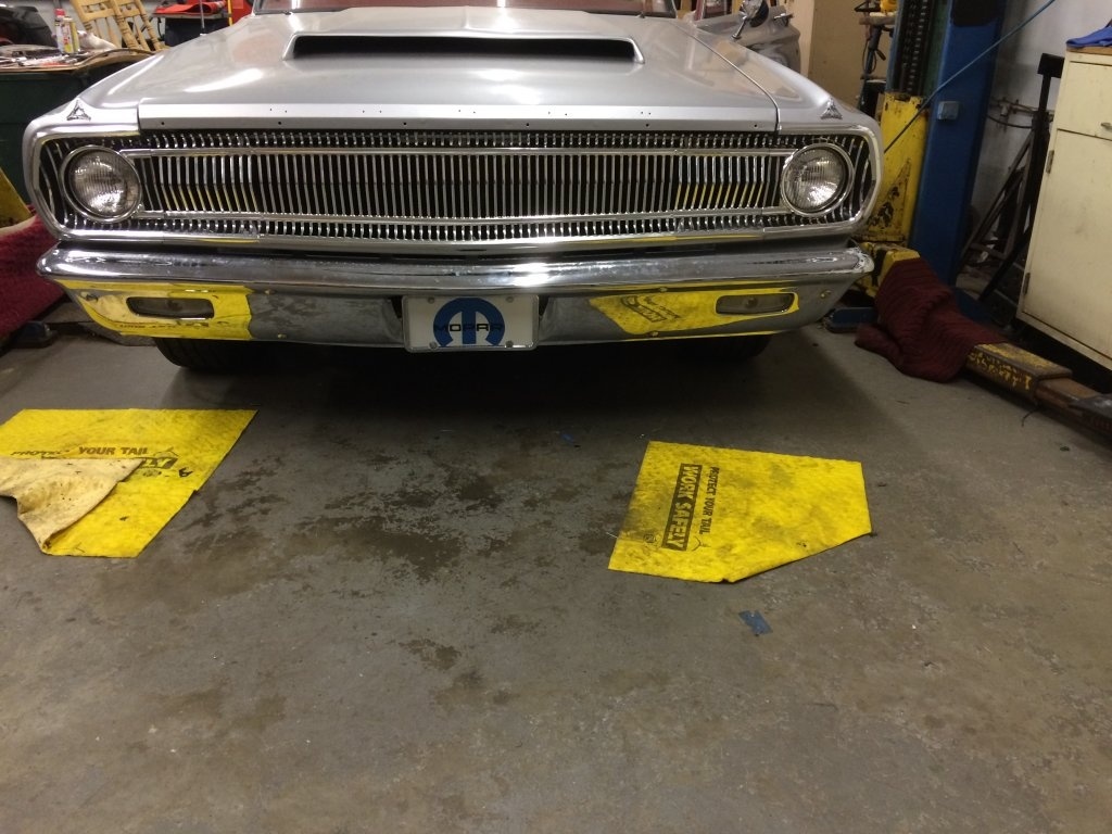

i had Zack tin out and polish my grill, but i havnt figured out how to make the bends in the exentions, any tips
Take your time the biggest thing is the bends in the pieces you cut out. They are more agressive out by the headlights cuz you have to get the width the same as the headlight bezel. The other end is wider where it meets the grill. Once you get that your good it will tell you what it needs.. Time and patience... I ruined 3 grills by not paying attention ! That gets expensive. Thanks for all the great comments guys searously I was ready to bail but you guys kept me in the game THANKS A MILLION "PAT "

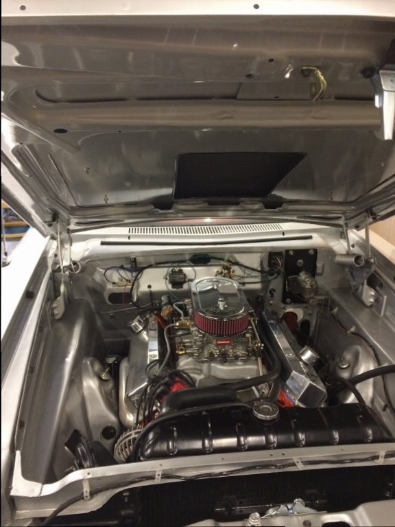

Ok no shake down . Had a &@!$ of a time getting the column sorted out . Had to change the coupler , readjust the linkage has it in and out 3 times Finally got it hit the key now I have a weird sound out front ! GOD KNOWS WHAT THIS IS. I'm going to name this car " Tre Duce" everything I've done has been has been repeated two or three times .. Everything.
OK turn the inspection plate around on the transmission bell housing and doesn't make any more noise put my door locks in and they all work.looks like tomorrow will be the shakedown run. Door panels armrests and figure out what radio i'm putting in and then I am done.!!!!!!!
Shakedown run happen today Got 20 miles on it no problems got a little warm just not quite 200 but I think it's a timing issue. Drives like an old car. Now it's time to clean it up and drive it .
