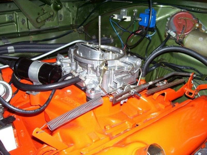

I just did what your wanting to do a couple of days ago. I have a basically stock 440 in my '69 r/t and the stock 4618 avs was just burning too dirty at low rpm for me. so, I put a 1407 edelbrock on it. I switched all the choke stuff and primary throttle shaft over to mopar and other than the location of the mixture screws it looks mopar. currently I have .110 primary jets with 68x47 metering rods, .104 secondary jets and .110 needle and seats. I don't have a bunch of time on this yet but the initial drive was very good. engine was very smooth, starts good, drove nice; which is what I wanted.

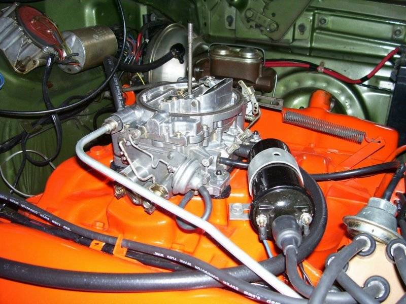

I run the 4640 Carter AVS 750cfm on my 1971 383/432 Stroker
Had an excellent core to begin with though , and yes thats half the battle
Replaced the 6125 S Carter AVS that was on my 383 Magnum
I rejetted using edelbrock rods/jets , made my own plates , and blocked off the compensator valve
I just love the AVS series carb , mechanical secondaries and fine tune your air door , can rejet using edelbrock components , response is awesome off idle destroying the 275-60 tires

I'd like to know the measurement of your return spring and where you can get one. Been having problems finding a longer one that I can put a smaller one inside of. Looking for 9 1/2" long.
that spring is original to the car. unfortunately in my younger wisdom I trimmed about an inch off of it 35yrs ago. I think the repop is what they call the gray spring, although this spring wasn't gray.
