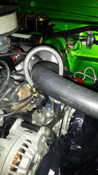

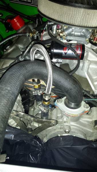

Got it tied off, as you can see: about 3" length each of 1/2" & 5/8" heater hose, stainless worm clamps at both ends, copper male barb fittings inside with opposite 1/2" threaded FIP, the hose that connects is stainless steel with small silicon washers inside each male end, though still I coated the threads with oatey great white pipe joint compound good up to 500F (hopefully it holds up...). Now I have the challenge of filling the rad back up without having experience with this strange coolant reservoir....

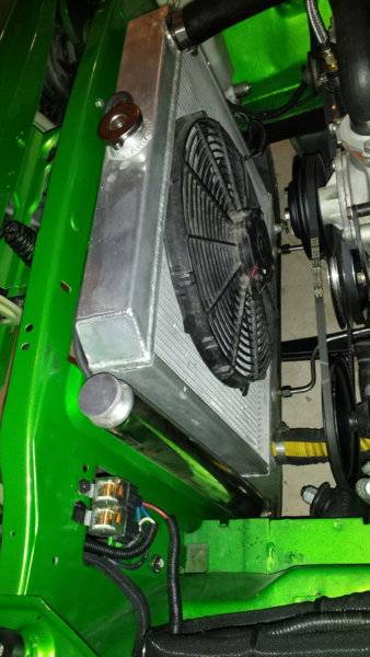

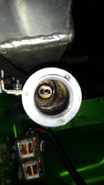

Does anyone know the protocol for filling up this coolant reservoir? Should I pour antifreeze into the rad and monitor how the level rises in the overflow tube? How high? Engine will be cold, naturally.
FYI I did not drain the cooling system from the rad nor block. I just crimped each heater hose one at a time with my only set of vice grips before popping each one of them off the water pump and quickly plugged the water pump nipples up with corks. I first did the 1/2" hose and when I released the vice grips it dumped a ton of fluid out of the heater core 1/2" hose while the 5/8" hose was still connected. So probably the system dumped a lot of fluid this way through capillary action (overflow reservoir is bone dry).

I would just top the radiator off and fill the reservoir up about a quarter of the way. Its designed to receive overflow when the coolant heats up and the radiator will draw from it when its low. Just keep an eye on the level in there for a few days and it will find its happy spot.
