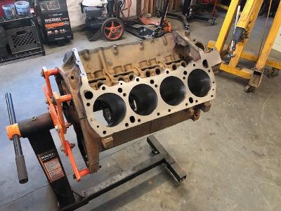

Stock 383 block, bored .030...

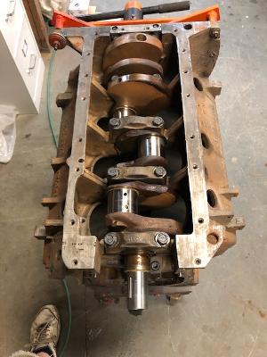

Stock 383 crank, cleaned up with no machine work needed.

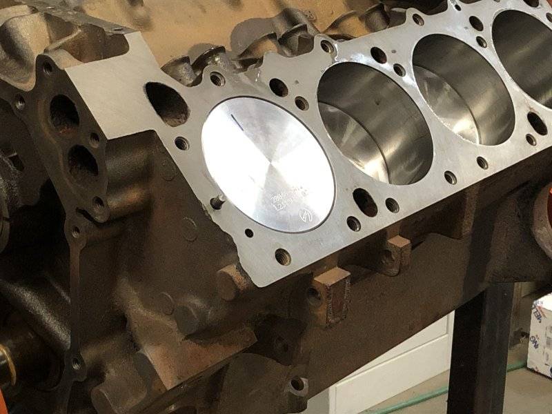

Speed Pro pistons. Block square decked to achieve .015 deck clearance.

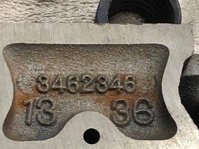

'346 heads with mild port job, milled approx .070 from stock measured 84 CCs.

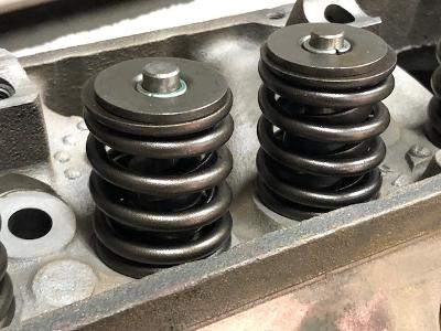

Springs rated for the 280/474 MP cam.

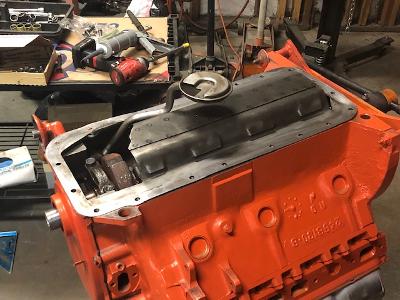

Stock RB stroke windage tray....used and on the shelf so I put it to work here.

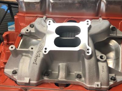

Edelbrock Performer RPM intake.
