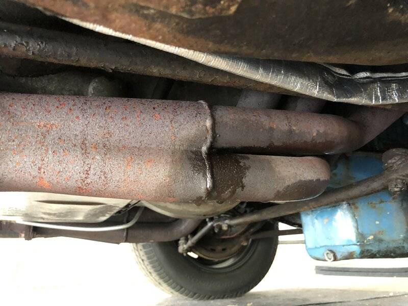

Changed header gaskets, new valve cover gaskets, new oil (Amsoil ZRod), and added a M/E Wagner PCV Valve setup (still dialing in). While tuning the pcv valve I noticed a new oil leak on the passenger side - literally dripping from my header tubes. I thought I was burning off spilled oil/coolant from the prior work I’ve done - but then got under and saw oil dripping.
What am I looking at here? Thanks guys.
Bad valve cover gasket or just needs a tighten?
I tightened them a bit as there have been a few heat cycles now.
However - it seems the oil is inside the header pipes and seeping/dripping out - not oil on top of the headers. I see almost a pooling of wet on the bottom of the header tubes at the lowest point by the collector - pic above - and that’s where it is dripping.

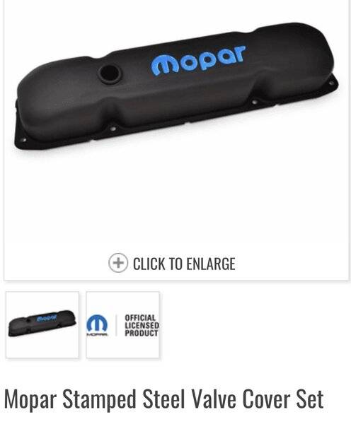

What valve covers? My bet is that they are stamped aluminum, I had a set of Moroso's that leaked in the back corner and was hard to see until I got up underneath and looked up at the block/ head. Went through 3 different sets of gaskets, wasnt until I changed out to a stamped steel set did the leak clear up.
What valve covers? My bet is that they are stamped aluminum, I had a set of Moroso's that leaked in the back corner and was hard to see until I got up underneath and looked up at the block/ head. Went through 3 different sets of gaskets, want until I changed out to stamped steel set did the leak clear up.
I have these:
I don't see how that's possible to have oil inside the pipe that leaks out unless the pipe has holes in that area. Any smoke coming out at the tail pipe?
Agreed. Unless they are "slip tube" headers (don't look like it), there's no way for oil to "seep through" the header tubes. Therefore, it must be dripping on them from outside and valve cover gaskets are BY FAR the most likely problem.
Or possibly the oil pressure switch/sending unit but most likely valve covers.
I don’t see how it would be possible for oil to be inside the pipes either, which is why I was asking.
Previously when I had an oil leak from the valve covers, the oil dripped higher up on the headers towards the flange - right below the valve cover. So I am perplexed that if it is still an oil leak stemming from the valve cover how the oil is missing the spot it normally does and is falling all the way down to the collector area at the bottom.
In addition, in the pic you can see the “stains” of oil on the header tubes and they are collected on the side/bottom where pooling would occur - not sure how valve cover leak would drip way down there, and only on the side/bottom?? I have no idea.
This is what led me to my hypothesis and subsequent question. Would be my 4th gasket on this side - drivers side has always been perfect when I’ve replaced valve cover gasket.

Not anything unusual that could not be contributed to temperature fluctuations - just a ton of smoke from the headers where the oil is deposited when motor starts to warm up.

I will look at valve cover gasket again - but there is no “drip” indications anywhere that oil is dripping onto the headers - look at the pooling of oil on the header tubes today from overnight....?? There has to be gravity at play here with where the oil is pooling - I just changed oil and put in the same amount that was taken out when I drained the old oil (7.5 qt). Is there excess oil?

I’m also wary of the oil pattern on the headers - seems odd for oil to be at the bottom, of the lowest points, if oil is dripping from the VC.
