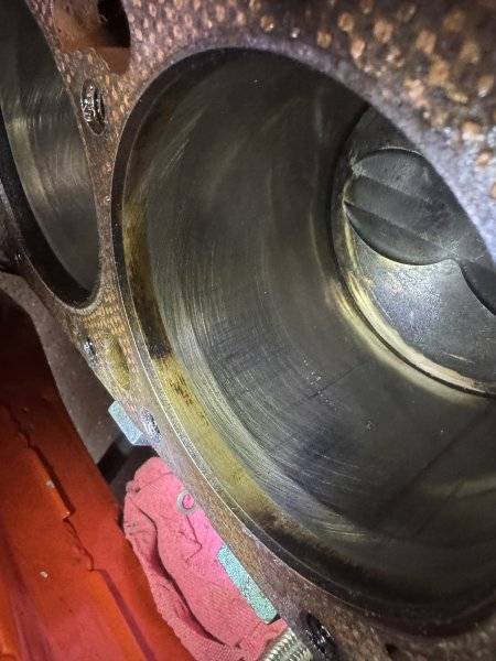

Usually there is coolant in the cylinder it will be washed clean. There is a clean area on the piston shown. Are there any other pistons clean in that spot? I have not seen a crack in the deck. Cylinder walls (usually easy to see) outside between the freeze plugs as well. Should’ve aired up each cylinder with the radiator cap off before it was taken apart.
Doug
this is the only clean cylinder. I ordered a dye pen kit to check the suspect areas. If all is well, I'm thinking about reinstalling the head with a new gasket then pressurize the cooling system without completely reassembling the engine. Should have done a bit more testing before disassembly but I never considered having a cracked block. The engine needs some more "get up and Go" (dyno report is embarrassing) but replacing the block wasn't on the list.

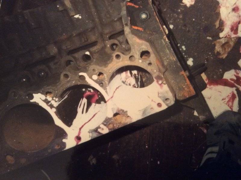

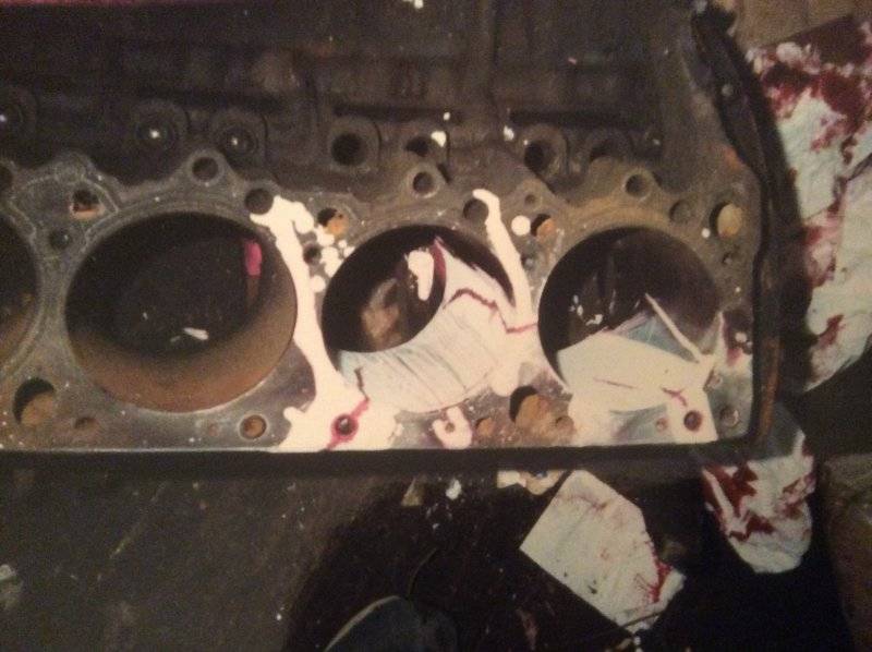

Cracked blocks are heart breaking event,MO. Here's a killer because of previous owners careless storage. When I was loosening the head bolts 2 were loose. I was checking the engine before buying my Satellite.

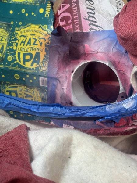

The cylinder & head passed 2 DIY dye pen test and they appear to be good to go. Thinking about reinstalling the head and doing a leak down test on the cooling system. I consider myself a decent hobbyist mechanic and I need to confirm the fail point before I invest in a new set of aluminum heads
If you put the head back on I'd use Hi tack on both sides of gasket. Someone else might suggest something better?
Would that be considered burned and does it seal? Might want to lap the valve it to check the seal, who wants to put a head on with a leaking valve.
Definitely some type of high tack if it's a factory steel shim gasket. otherwise, no
