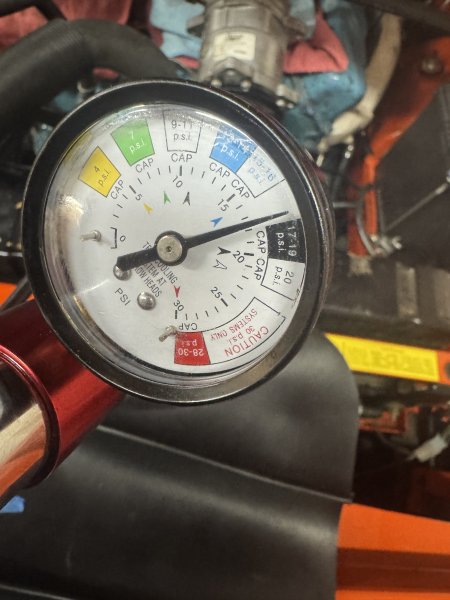

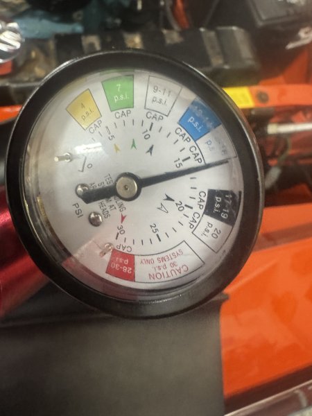

One white valve
Did you check that the exhaust valve is sealing good? Pour some low viscousity fluid like solvent or alcohol, or brake cleaner in the exhaust port and see if it leaks past the valve seat.
fillled both sides of the valve with alcohol and both sides held it for over 5 min with no leaks
