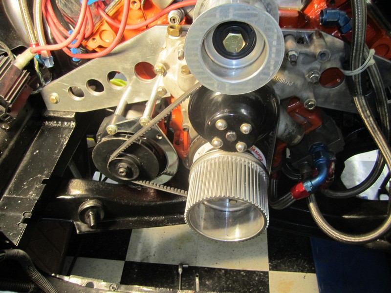

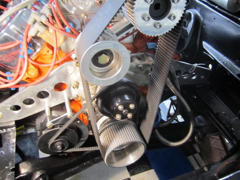

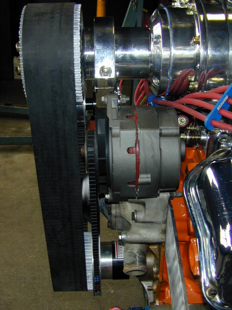

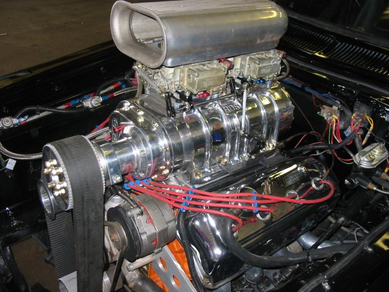

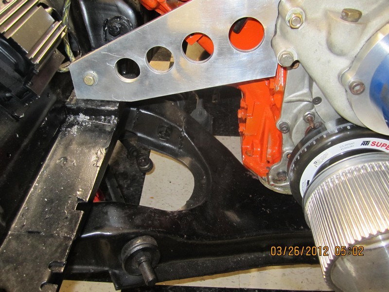

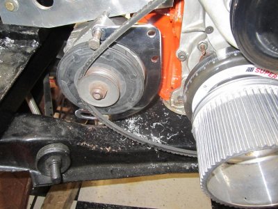

I just relocated my 100 amp 1 wire alternator from having it mounted on the power steering ear of the water pump to under the motor plate low on the passenger side:icon_rambo:
This alternator was obtained long before a 1 wire MOPAR alternator was available:icon_hang:
