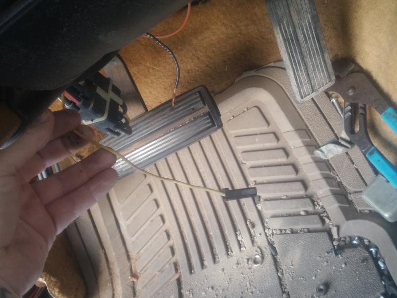

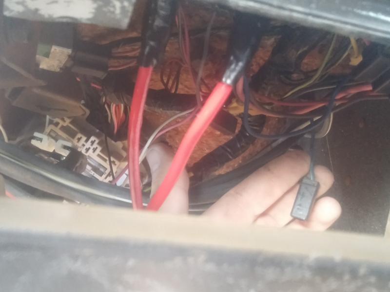

I got my standard dash put back in and everything hooked up. I have mysterious yellow wire that has a plug in it that comes out of the column cluster with the other wires. I'm sure its important. Just can't figure out where it goes. I also have a black wire by fuse box I can't trace down. And one blue wire behind radio. 20150129_170207.jpg20150129_170056.jpg20150129_165727.jpg Help please.

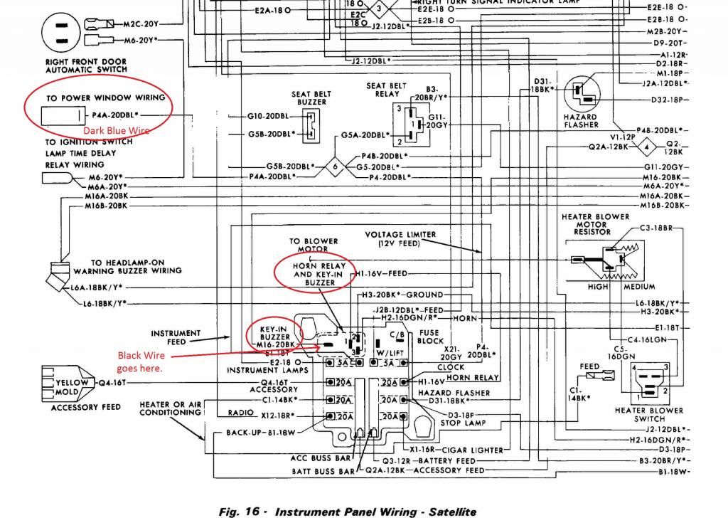

Check out this wiring diagram
http://www.mymopar.com/downloads/1973/73CoronetChargerB.JPG

nacho this yellow wire with the female plug is the one hanging from the steering column.. im sure its for the courtesy light as you say,but i cant find a male to plug it into. it can reach almost all the way to the ac switch and almost to the ash tray...

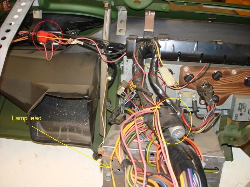

Dunno why I recall this being male and not female ( whatever )... The delay flasher got its own harness, which plugs into a pink fee/mold ( constant batt ) and to a black feed/mold with yellow wire ( door jam ground ). Both are bullet teminals... then another yellow wire to feed that bulb.
http://i226.photobucket.com/albums/dd81/dewilkinson/GRP-08-PG-163.jpg
http://www.dodgecharger.com/forum/index.php?action=dlattach;topic=78814.0;attach=149632;image
Some changes allong the years and bodies but you can get it now... you should have that cilinder "thingy" hanging around. It got its own harenss since was optional

I recall the cylinder but I believe its behind the ashtray,but I'll double check. Man wish I would have taken more pics so I would know this one stand alone yellow coming from steering column. Door jam light switch wires are hooked up correctly. I personally redid those and yes they were females that plugged into blade fuses. Thanks for all help guys

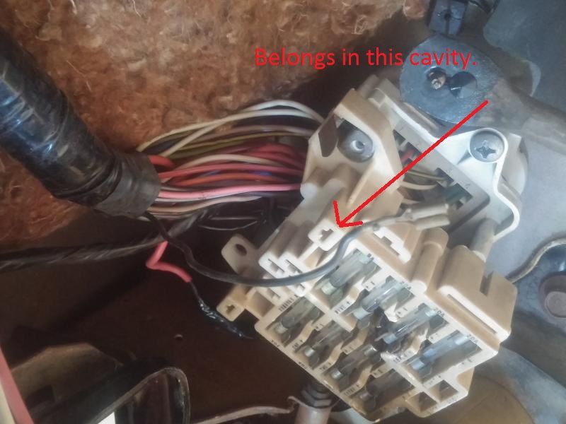

Black wires arriving to fusebox/bulkhead are:
--Horn wire or key in buzzer--fusebox section. Check if the 4 cavities for horn relay are full. Can be either for key in Buzzer or horn trigger from steering column ( two of those cavities get black wires... the other two are green traced red and violet )
--Brake warning light---bulkhead section... must be an empty cavity left on bulkhead ( cavity 24 by 73 diagram )

It appears that some of my photobucket pics have been liked here so I will add my two cents, as mentioned the yellow leads to the key switch illumination lamp, black wire near the fuse panel is the key in switch buzzer ground. Commonly removed from it’s cavity at the horn relay to disable the buzzer. The dark blue wire with the female insulated spade connector is labeled in the FSM as for power windows, likely trips the power window safety relay.

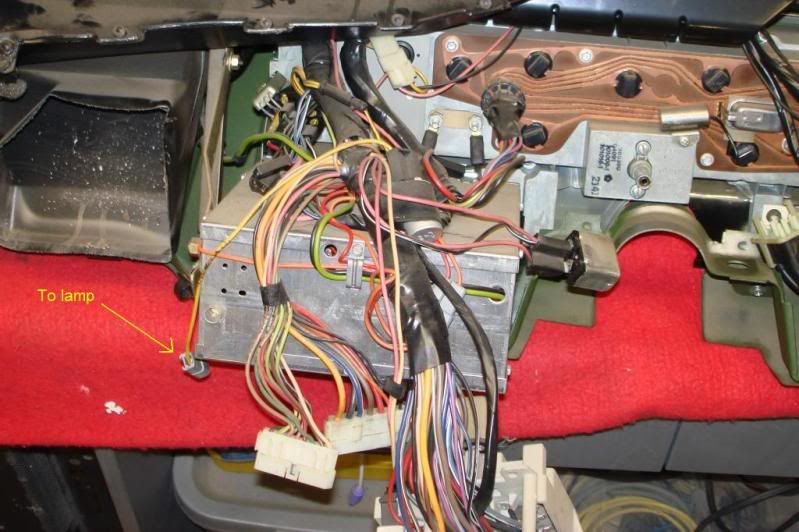

That is correct, one of the pictures linked shows the timer/relay and its related harness, including the connector the lamp lead plugs into (noted by "to lamp");

No, not really, nothing to do with a lights on buzzer, big differences between ’69 b-body dash wiring and ’71-74. No key in ignition buzzers until ’70, combined horn relay/key buzzer fuse box mounting started in ’71 for the b-body. The black wire is not a power lead, it is a ground via the key in ign. switch micro switch, via the left door jamb switch.
I'm gonna have tonget back under dash and find the yellow wire that your showing coming from dash harness and plug into column wire hanging, then I'll just work on the black wire because it seems I'm getting a couple different answers on it.
