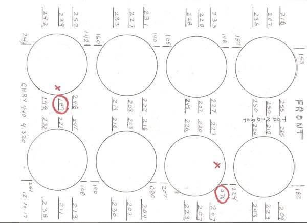

Here are the results from the sonic check - :(
I would be nervous about the .076 and .080 non-thrust at that power level.
I once had a 400M Ford that ran about 200,000 miles with .045" non-thrust in some places - amazing. But that was at only 260hp or so. Built the engine to about 350hp, now at .040" min non-thrust, it lasted another 1000 miles up in cool WA weather, but wall split as soon as I got on it in 90F+ CA weather. THEN I measured. Same as comments above - lifetime depends on power level, and always do a sonic. I would add that lifetime also depends on how hot the engine gets. Looks like you are in a hot climate, and at 700hp I guess I'd worry about a non-thrust split. Usually not catastrophic, I nursed mine 80 miles to get it fixed, but it still made a mess and the block was now worthless.
Yea, I'm not gonna use this block . . .
Sleeve the two holes and move on with the build. Procuring another block, cleaning, and retesting will cost more than the two sleeves.
Sleeves won't help, it is standard bore now. I want to go .060 over on this build - I've got a line on a Mopar Performance Siamese bore block. Hopefully I can score it.
Though the MP block would be more desirable why do you think sleeves wouldn't fix it? Many different size sleeves available.. 060" over won't bother anything
Doug
Doug[/QUOTE]
How is a sleave going to get me a 4.38 bore with adequate cylinder wall thickness?
Doug
How is a sleave going to get me a 4.38 bore with adequate cylinder wall thickness?[/QUOTE]
Get a sleeve designed to accommodate a 4.380 bore. You wouldn't use a 4.25 bore sleeve. They come in many sizes.
Doug
You use a sleeve to get the minimum thickness to where you want it. Or just to replace the cast iron with a better material... There's a reason NHRA didn't let racers sleeve all 8 holes - because they are stronger than stock walls. Like dvw said - get the right sleeve and do what you want. Or go find more blocks, and sonic test them. BTW - most of the MP blocks you will find are terrible. They should be sonic tested too. Especially if it was never run. Some really poorly cast ones were sold, but they were never used and you find them for sale now. Don't pay big coin for any MP block until you see the sonic test results - even the Siamese bore versions.
Typically how thick are the sleeves? Also what would be a safe combined (sleeve & cast wall) total thickness?
Doug[/QUOTE]
How thick a sleeve would you recommend, where would you get this, and have you ever done this?
Food for thought. How well will this sleeve seal out the water when it removes most of the existing cylinder wall? How much does this distort the adjacent bore? If I sleeve two next to each other, how much material is left between the bores at the deck? How close am I to the bolt holes and water holes?

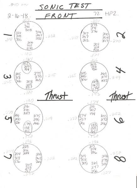

Well, I've decided against the Mopar block - too much of a risk (distance, price, possible shipping damage ETC) I purchased another std bore block from a friend who is a Stock Eliminator racer - says he had it sonic checked and it can go .060. I'm going to have sonic'd again, "Trust but verify" - Ronald Reagan.
Here are the results from another block I bought from a friend - this one is much better, I had Bob Mazzolini sonic this one. I've decided to go 30 over - Any opinions on if a partial block fill would be beneficial?
