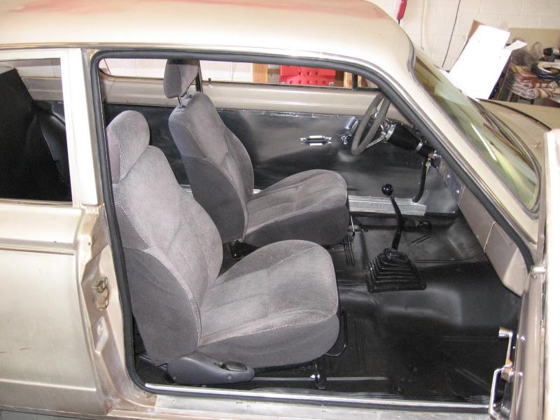

I rattle caned the floors and under the car with Rustoleum truck bed liner of my 65 Belvedere.Held up great.I also used it on the floors of my 64 Dart and left the floor bare. Same thing not even wear marks from shoes. Good cheap product
