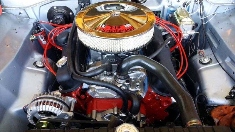

that car in my thumbnail has a 1978 318 in it. dynod at 325 hp. fun for a cruiser.
