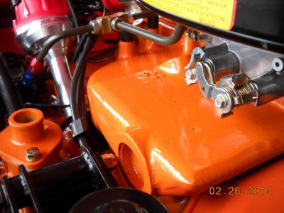

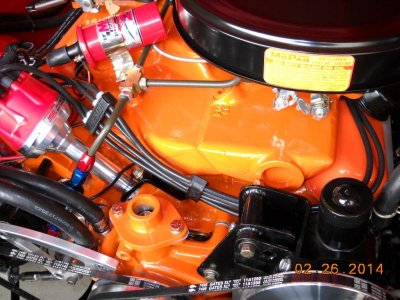

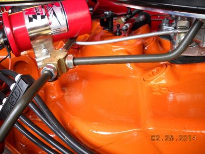

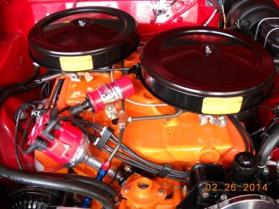

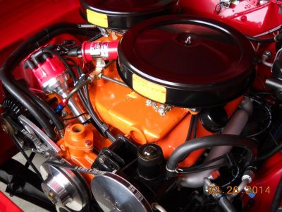

Mopar Performance Race Hemi Orange rattle cans. Note gloss...NOT comparing with a professional paint job, but total cost was under $20. and I still have 1/2 a can left. Worked for me...
Sorry about the double picture posting... It'll teach me not to answer a phone call before I hit the submit button.
