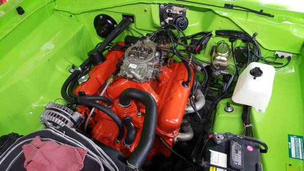

I don't think PPG has engine paint codes, just the car paint codes - PPG 2186, V2 paint Dodge Hemi Orange or Plymouth Tor Red Paint . Here is Tor Red V2 on my Duster.
