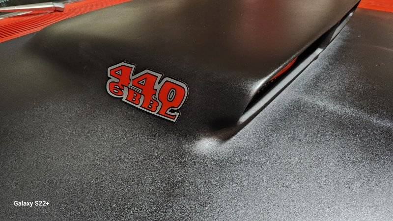

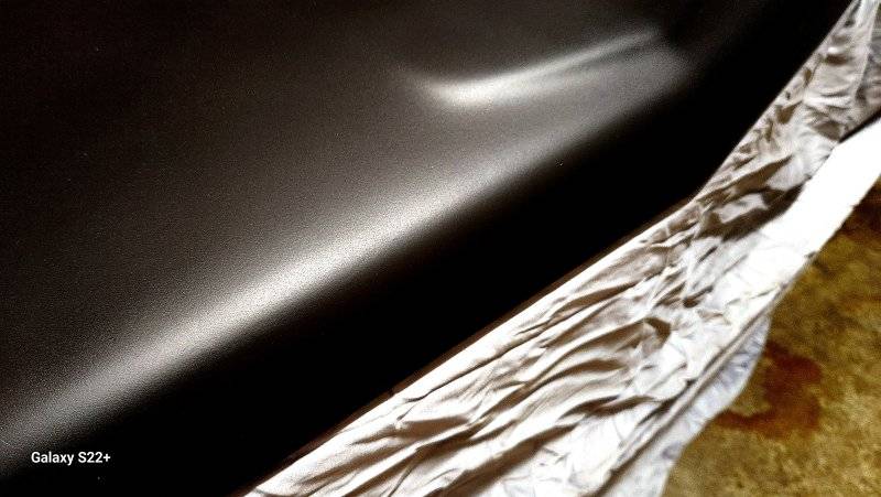

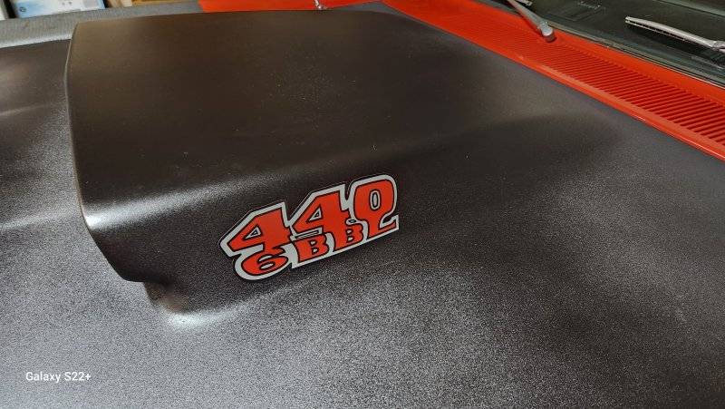

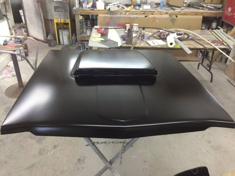

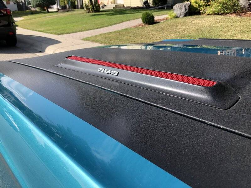

I sprayed Organosol 23 years ago and never had a problem with upkeep. But, I did have a problem spraying it. It came out of the gun like cotton candy and laid down like it as well. I sprayed several layers, hoping it would liquify and spread - it never did. After it cured,I knocked it down with 3M’s Scotch-Brite pads and then rubbed reducer over it to remove the gray and bring it back to black.
View attachment 1556667View attachment 1556668
Yeah my father used to paint all kinds of HotRods, customs etc. I vaguely remember him fighting that stuff, had to DRILL out a nozzle on one of his old stainless guns just for Organisol. (Yours looks great, BTW)

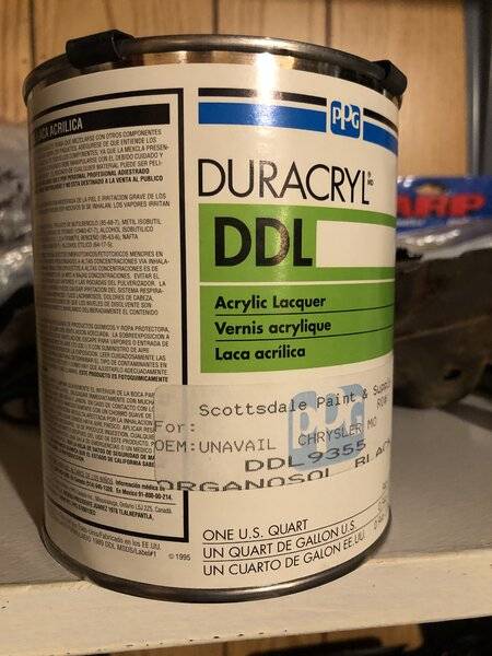

Thanks, PPG DDL 9355. Pretty sure you can’t get it anymore. I have one quart left never opened.

Not sure on that. It would probably be a pretty expensive quart of paint as its the real deal.

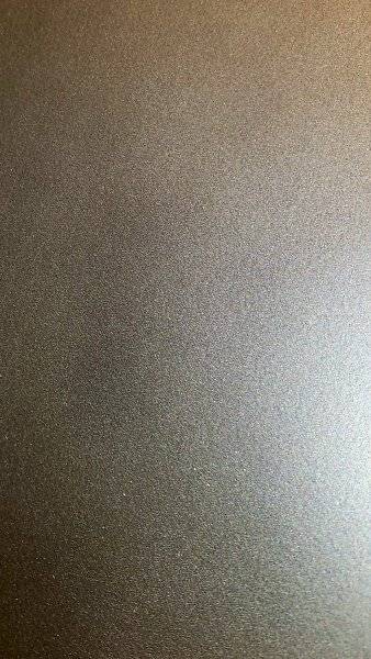

I beleive so.. I'm gonna try that SEM Hot Rod Black. I haven't painted cars in years, but Im only looking to do the hood at this point. Yeah I'd say that quart wouldn't be cheap! I spoke to my father a bit last night about the entire "Painting" thing, as he used to paint cars for FORD and in the shop he owned. Crazy how this stuff moves so fast with technology.

Wonder what size TIP one would have to use with the Organisol or even the SEM Hot Rod paint? Its been quite a while!
SEM "hot rod black" cleans up with windex and a paper towel

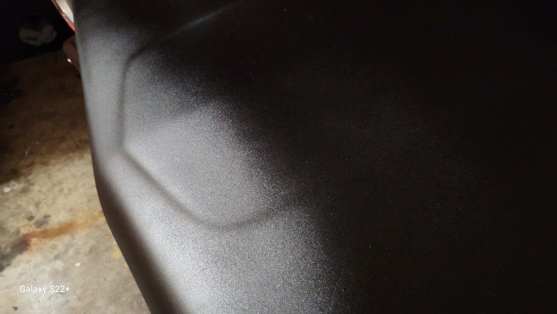

What size tip would you use for that SEM? Pretty sure my old spray guns would shoot it ok. But I'm unfamilair with what ratio probably 20% or 5-1?
shoot it like you would single stage or clear coat, it's lust black urethane with a flattener in it
it lays out smooth, so don't expect a textured finish.......
you can't sand it when you're done, so get the job as clean as possible......... I like to hang panels when ever possible so as not to collect dust
