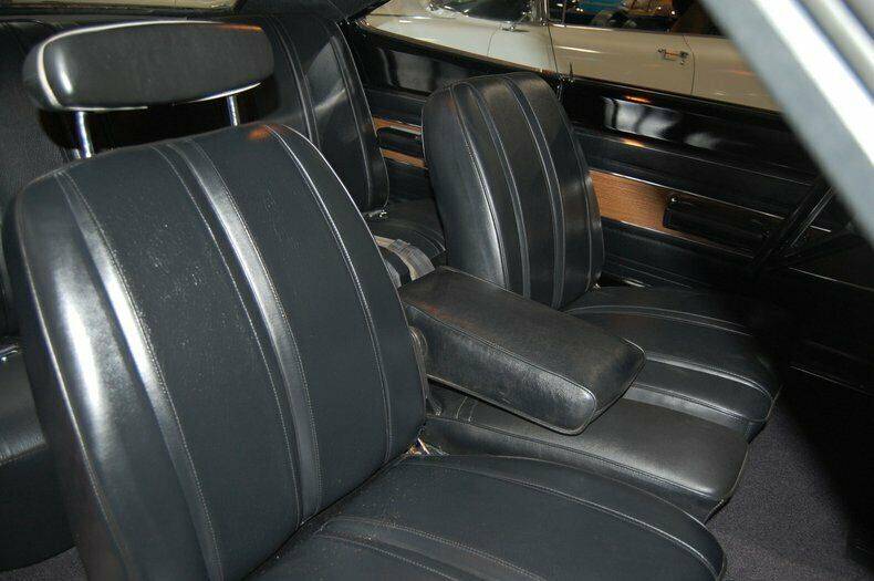

One headrest was absolutely available in 68, most times it was the drivers side but strange stuff got ordered all the time... Looks like a nice 68, great color combo... Not quite as original as it's being hyped as but I've seen allot worse... I doubt you'll get it into the high 30's.. But good luck!

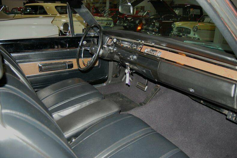

Here are some photos I have of car.If you notice something is missing on drivers seat.They say that was the way it was ordered????
Mine was an early model year production and has no headrests, but I've seen them with one or both...

If everything checks out it’s probably not a bad price from a dealer. The single headrest I would drive me nuts. It’s also not console car, that would detract slightly for a GTX IMO.

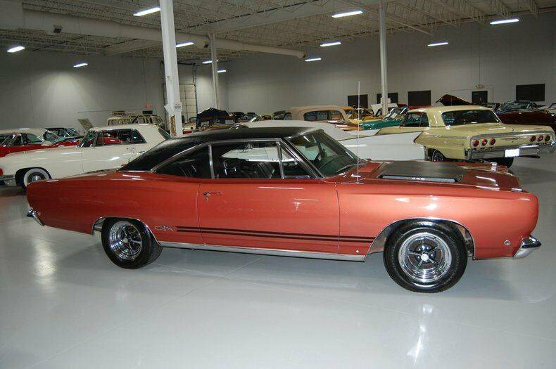

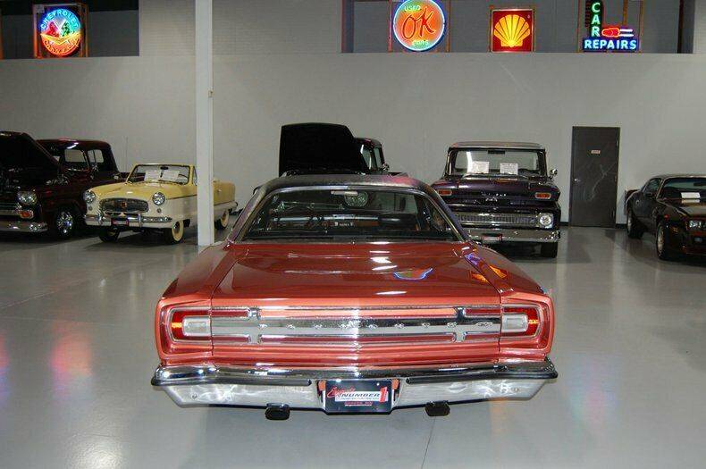

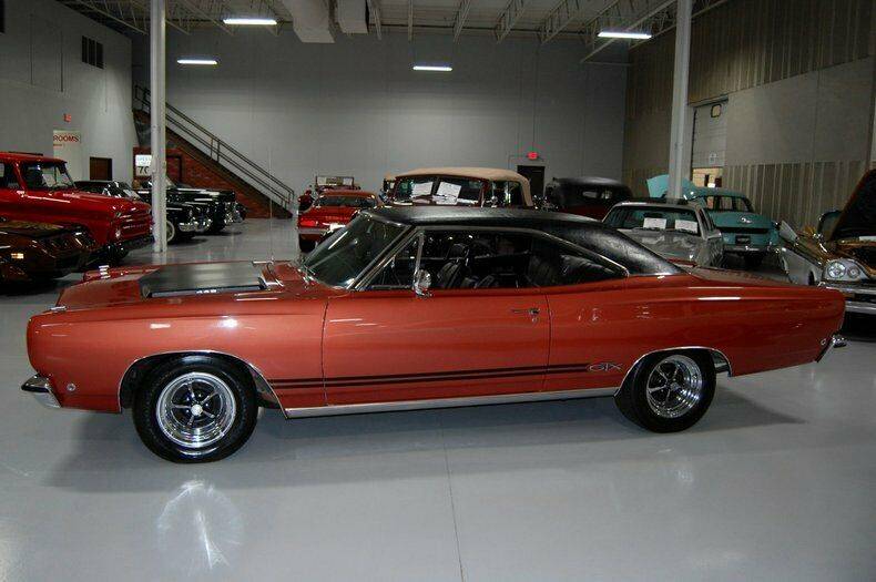

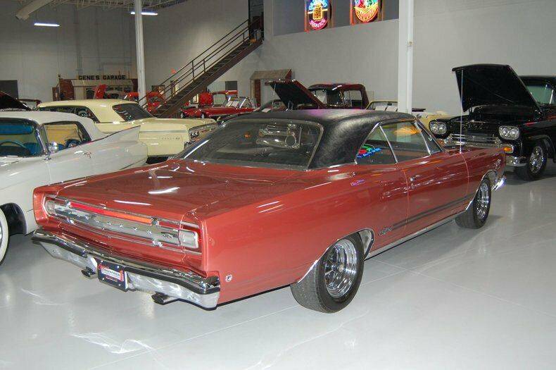

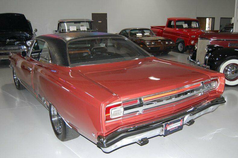

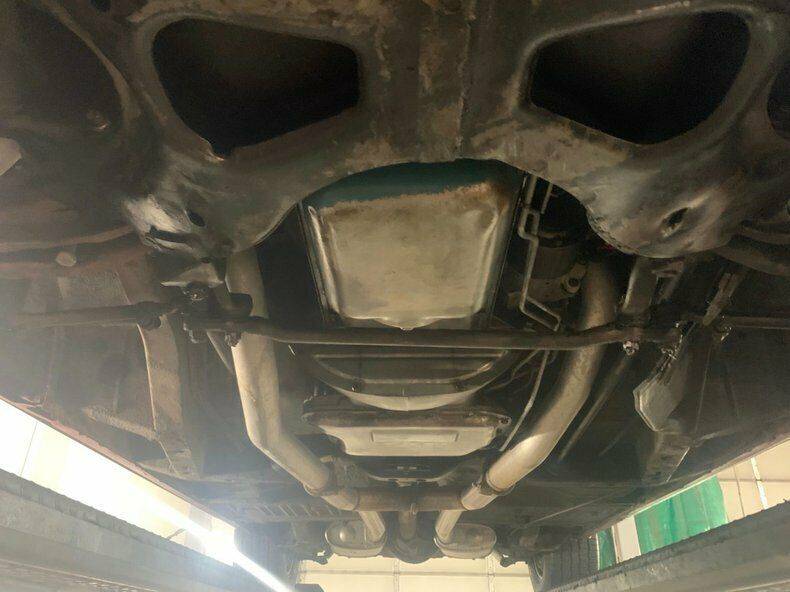

Judging by the grain on the vinyl roof, I'm 99.9% certain the the vinyl roof has been changed, the exhaust tips don't look right and I see that some items in the engine compartment have been changed, which is no big deal. Also, the argent finish on the trunk panel has been wiped off and is down to the chrome. What I like to look at are the bottom edges of the car. ie: where the quarters meet the rockers, all of the pinch welds around the wheelwells and behind the rear wheels and especially look at the trunk floor. I strongly suggest that you see it in person and get it up on a lift and look at everything underneath for yourself, including pulling off the drain plugs on the trunk floor extensions. While up on a lift, you can inspect the lower portions of every body panel to see them from a different angle. There is no paint on the valley pan, which tells me that the intake manifold has been off and the paint on the valve covers looks too good for 53 years.
The car looks nice from what can be seen in the low quality pictures and after 53 years, it's not surprising that some items have been changed.
The car is being sold through a dealer & they will say anything to make a sale. I sure hope that you are going to invest the time and plane fare to look at it in person rather than spend 40+ large on it sight unseen.

I also just noticed that someone painted the grille black.

Can you guys think of a reason they would change vinyl top.I am sure it has to be a bad reason!!!!
The dealers' video on the car answers (supposedly) the headrest question - but also misstates
several things. Fella seems like a nice guy, just not terribly informed...

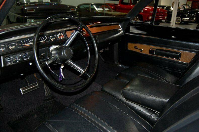

I’m basing following comments on early 68 Coronet R/T instead of GTX, but I’m assuming running changes would have been similar. Appears to have been a pretty early build car based on the SPD of 705, or July 5.
1. It has later style pull out metal faced ashtray instead of earlier padded one that slides down.
2. Has later 1 - 15 speedo instead of earlier 10 - 150 speedo.
3. Has earlier graphic on water temp.
4. Has later padded horn button instead of chrome one.
5. Appears to Have later style rectangular vent pulls instead of round ones.
6. Appears to have incorrect for 68, or early 68 (don’t know when they were moved), interior door lock button location. They were moved further back by a bit by 69. When you put your arm on window sill early location ones are right where you rest your arm. It could just be poor photo quality though, difficult to see clear enough.
My 68 R/T has a later SPD of 911 and has all the earlier features mentioned. None of the later.
