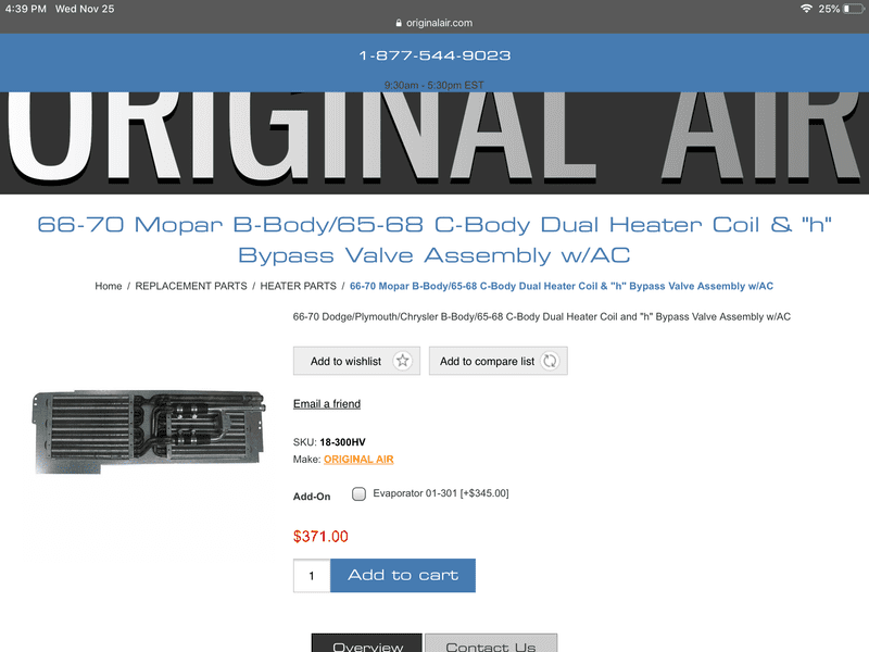

Any input on these heaters cores? Now that I have dug into ours, I need the heater core rebuilt/replaced, the bypass valve shown rebuilt/replaced, and the heater control valve at the firewall rebuilt/replaced. For Gary to rebuild my core is $300. I can’t find rebuild kits for the bypass valve so $75 if you go new. I have not found a rebuild kit for the control valve either and haven’t priced new/rebuild kit. I would rather rebuild myself but if these are good quality it kills 2/3’s of my problems.

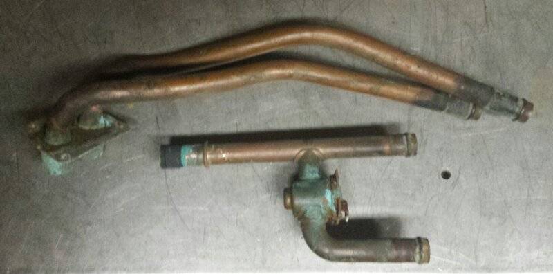

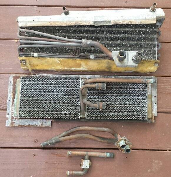

Spoke with Joe at heatervalve.net. He can handle the heater valve but doesn’t rebuild the h valve. Any source out there for rebuild/parts of just buy new? Classic has them new for $75 which seems pretty steep.
I have these ac parts if you still need something
Do they sell a heater core that u don't have to use the h valve to get heat only not really worried about ac
Bypass the valve if thats what you want.
Not that I'm aware of. Because of how the system is plumbed with the copper outlet pipes you need the h valve for the hoses to hook up properly.
